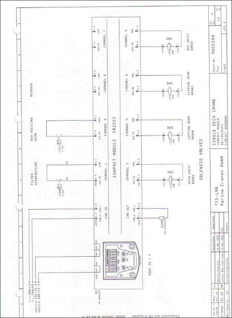

5.5.2 ADJUSTMENT OF THE CONTROL OIL PRESSURE (BOOSTER
PUMP)
This special mode will have to be activated in order to adjust the control oil pressure without starting the main drive motor - only the motor =M02-M11 for the booster pump (control oil supply pump) will be started / stopped by the <START> switch.
During this special mode possible low-pressure-alarm is suppressed, the technician must take care that there is oil in the system and the pump is running with the right sense of rotation.
On the display is shown the average pressure measured in the hoisting gear circuit.
Work on the electrical equipment of the crane is to be performed only by fully-trained personnel.
All procedures described as follows can influence the crane operation system and therefore it is only possible to enter this secured area after activation of a key-code.
Keep the code numbers secret for activating the secured area.
Only a crew member who has been put in charge of the cranes by the management of the ship should be allowed to override values or messages in the crane computer system and must take the instructions given here into account.
Procedure:
• Set MAIN MENU
. Select SECURED AREA (KEY-CODE IS ON DEMAND)
. Select CONTROL PRESSURE ADJUSTMENT
press ENTER and SELECTION
to set = TRUE or reset = FALSE this special mode

7/3063-7/3064 ELECTRICAL EQUIPMENT
F 3080 SLEWING PWM-OUTPUT FAILURE =M07-A3
F 3081 SLEWING PWM-OUTPUT FAILURE =M07-A7
The control current for the proportional solenoid values of the pump is generated in the Compact Module by Pulse Width Modulation. Fault message appears when no control current measurement (actual value) is taken although the corresponding PWM output is activated by the nominal value .
The drive condition can be displayed:
. Set MAIN MENU
• Select INDICATIONS
. Select DRIVE VALUES
Remedial action:
- Check the wiring to the solenoid valve.
- Check the resistance of the solenoid coil, (approx. 24-300)
- Replace the PLC or the Cabinet Module.
