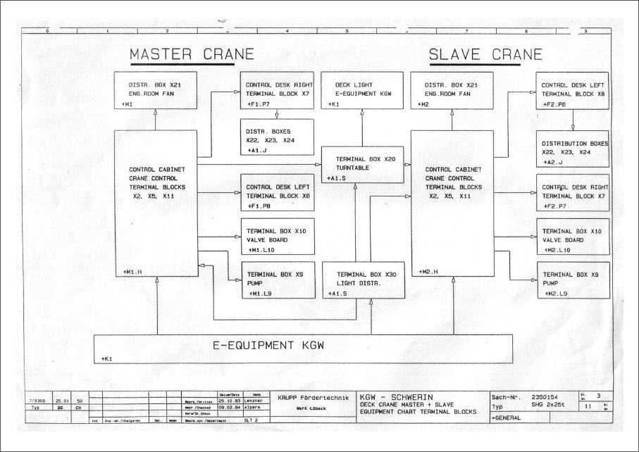

Motor list
Pump drive : 2 X 125 kW - si, 4 poles
Feed oil pump : 2 x 9,0 kW - si. 4 poles
Machinery space fan : 2 x 1,3 kW - Si, 2 poles
Hydr. oil cooler : 2 x 0,9 kW - Si, 4 poles
Gear oil cooler : 2 x 0,37 kW - Si, 4 poles
In the description of the electrical equipment the assembly groups and components of the master crane are marked with an "M" (e .g. =M60-M1 : pump drive motor); for the
slave crane the same motor is described as =S60-M1.
The respective position in the master crane is marked with digit "I" (e.g. +A1.J : jib); in the slave crane with
digit "211; the jib position in the slave crane is designated by +A2.J.
The following description uses the master crane identifications .

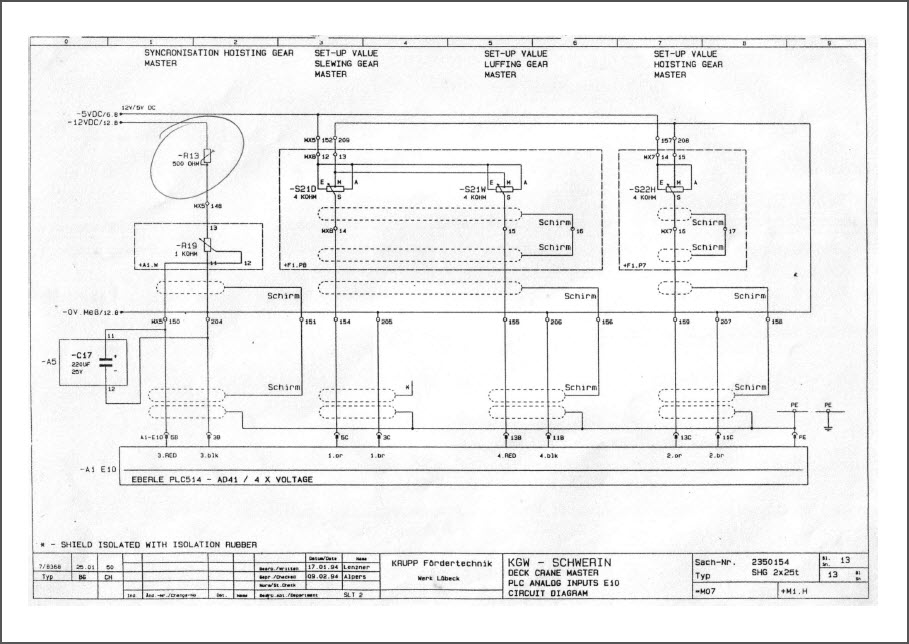

5. Adjusting the synchronism transmitters
Readjust the* synchronism transmitters if the neutral point of the synchronism control system for the double crane mode has changed (e.g. if the hook spreader is not horizontal).
See the description of fault signals 48 and 49 for identification of asynchronous control states.
The procedure for readjusting the luffing gear synchronism transmitters is described below. The procedure for hoisting gears is analogous.
The reference point (RP) for voltage measurements is ±0 V of the DC supply voltage.
1. Luff both jibs into their highest positions (minimum outreach). The two jibs must be parallel to each other.
2. Measure the voltages at the outputs of adjustment resistors RIO and R12*. They should be between 10 and 12 V and must be identical. Adjust RIO or R12 if they are not.
3. Measure the output voltages of the synchronism transmitters (potentiometers in limit switches) at MX5-195 and MX5-117 on page =M07. Sh. 11 and 12. The voltages should be about 0.5 V. If they are not, adjust them by turning the potentiometer casing.
If the voltages differ greatly from 0.5 V, repeat the procedure described in point 2 above after rough adjustment of the potentiometers.
The two potentiometer output voltages now have to be balanced (fine adjustment).
Their absolute value (about 0.5 V) is relatively uncritical, but it is important that both potentiometer voltages are identical, for instance 0.487 V. Measure this voltage at the potentiometer itself, i.e. between terminals 11 and 12.
The output voltages are adjusted by slowly turning the potentiometer casings.
Remember that the voltage can change when the casing is tightened. If this happens, it must be readjusted again.
4. Now luff both jibs out to maximum outreach. The two jibs must again be parallel to each other.
5. Measure the synchronism transmitter output voltages at MX5-195 and MX5-117. Use adjustment resistors RIO and R12 to vary these voltages until they are exactly equal. Their value must not exceed 9.5 v.
6. Close the casing of the limit switch. The synchronism transmitters are not correctly set.
*On drawing sheet =M07. Sh. 11 and 12

Besides directional contacts, the master switches are equipped with potentiometers.
The potentiometers are supplied with 5 V, output voltage changes 3CC. to the angle of deflection from 0 to 5 V (0 v in zero position, 5 V at maximum deflection) .
