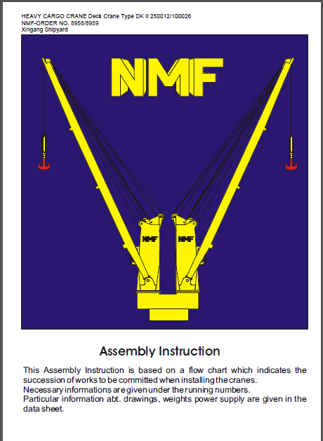

Assembly Instruction
This Assembly Instruction is based on a flow chart which indicates the
succession of works to be committed when installing the cranes.
Necessary informations are given under the running numbers.
Particular information abt. drawings, weights power supply are given in the
data sheet.
HEAVY CARGO CRANE Deck Crane Type DK II 250012/100026
NMF-ORDER NO. 8958/8959
Xingang Shipyard
Flow Chart and Content
