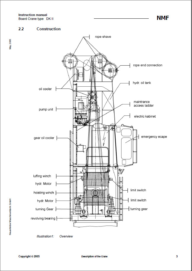

NMF Crane DK II 45 t. 45027,5/35032,2 / Instruction Manual Board crane
Year: 2005
Author: Neuenfelder Maschinenfabrik GmbH
Genre: Instruction Manual Board crane
Series: 27.06.2005
Quality: OCR without errors
Number of pages: 370
Description: Neuenfelder Maschinenfabrik GmbH
Type: Crane 1 DK II 45027,5/35032,2
Crane 2 DK II 45027,5/35031,5
Order-No.: 80099
Hull-No.: 2023
Buildingyard: Zhoushan Shipyard
Name of Ship:
Year of Construction: 2005
Edition 27.06.2005
Index

2 Description of the Crane
2.1 Technical Data .................................1
2.2 Construction ..3
2.3 General Aspects...............................4
2.4 Pump unit ......4
2.5 Lifting gear.....4
2.6 Luffing gear ...4
2.7 Turning gear ..4
2.8 Gear oil cooler ..................................4
2.9 Hydraulic oil cooler ...........................5
2.10 Heating ..........5
2.11 Slake rope switch .............................5
2.12 Gear limit switch ...............................5
2.13 Slip ring assembly ............................5
2.14 Load measuring bolt.........................6
2.15 Description of the electrical components.......................... )7
2.15.1 Electronic regulator print card ..........7

Instruction manual Board crane type DK II Illustration
Chapter 2; Illustr.1 Overview 3
