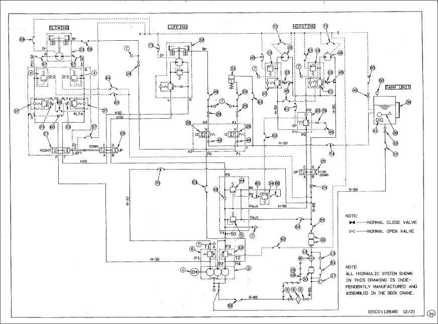

1-2 The arrangement of 30t X 24m (R) hydraulic deck crane 1-3 Pipe diagram

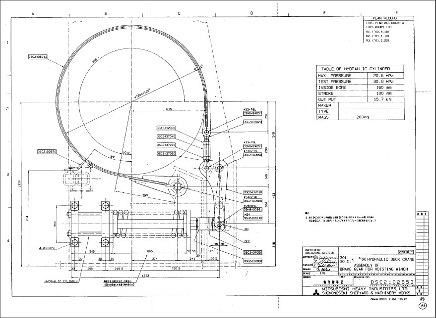

(7) Assembly of brake gear for hoisting winch DSC2102653

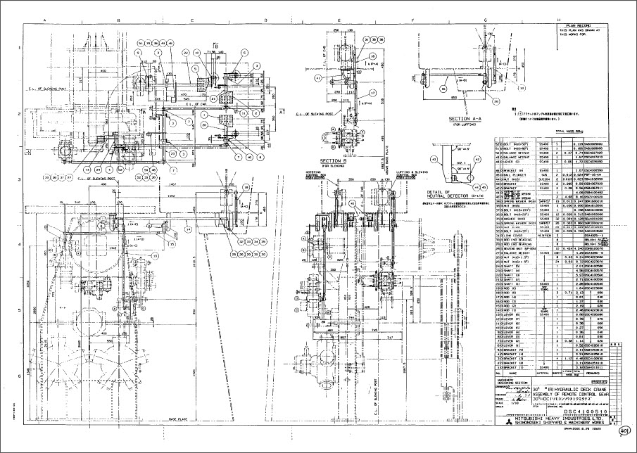

(10) Assembly of remote control gear DSC4100600

The hydraulic system for hoisting, luffing and slewing is composed of fixed displacement hydraulic oil pumps, fixed displacement oil motors, control valves, counter balance valves and other accessories.
Of course, the pressure relief valve is fitted in each circuit to prevent the line from over pressure.
The pressure oil delivered from each oil pump driven by an electric motor is regulated by the control valve and is supplied to each oil motor.
So, the speed of each motion can be controlled gradually by controlling the control valve.
The hydraulic system has two (2) circuits, one is for hoisting and the
other is for slewing and luffing which line is connected in series.
The return lines of each circuit are connected together.
The oil flows together in return line and flows through air cooled oil
cooler which is automatically controlled by a thermo switch and in a 10 micron-oil filter and then, oil gets back to each suction chamber of oi I pumps.
Furthermore, a head pipe with head tank connected to the return line gives a little positive pressure and supplies oil in the circuit for developing the sucking performance of oi I pumps.
