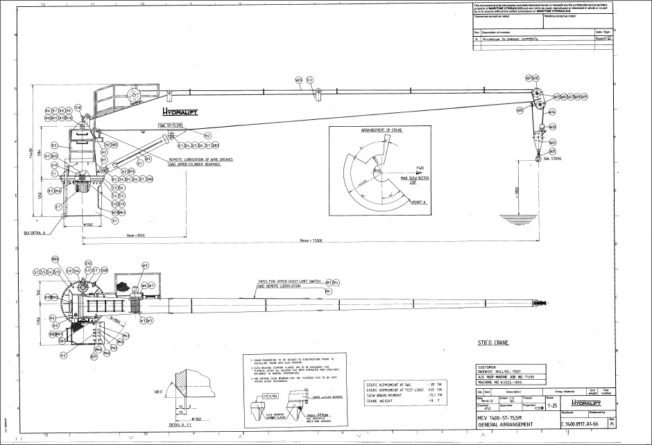

Tolerances except as noted Welding except as noted
Rev. Description of revision Date / Sign.
A According To Daewoo gommemTs 90-05.07 62.
PIPES FOR UPPER HOIST LIMIT SWITCH AND REMOTE LUBRICATION _______________
DETAIL A, 1:1
1. CRANE FOUNDATION TO BE WELDEO TO SUBSTRUCTURE PRIOR TO INSTALLING CRANE WITH SLEW BEARING.
2. SLEW BEARING SUPPORT FLANGE HAS TO BE MEASURED FOR FLATNESS AFTER ALL WELDING HAS BEEN COMPLETED AND STRUCTURE RETURNEO TO NORMAL TEMPERATURE.
3. FOR OPTIMAL SLEW BEARING LIFE THE FLATNESS HAS TO BE KEPT WITHIN GIVEN TOLERANCES.
0,190
SLEW BEARING SUPFDRT FLANGE
"-3L. CRANE w/SLEW BEARING
TORQUE = 62Kpm USE SPECIFIED BOLTS AND WASHERS
CUSTOMER:
DAEWOO HULL NO.: 5501
STATIC KIPMOMENT AT SWL. : 97 TM
STATIC KIPMOMENT AT TEST LOAD :117 TM
SLEW BRAKE MOMENT •• 21.1 TM
CRANE WEIGHT >8 T
A/S NOR-MARINE JOB NO.:71/90 MACHINE NO. K2S25-1890

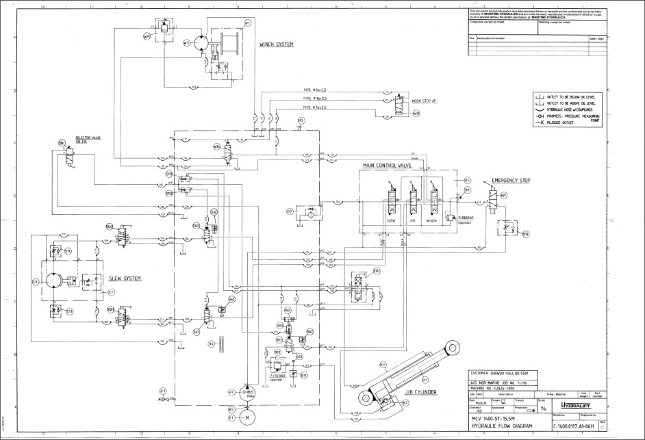

CRANE TYPE : MCV 1400-5T-15,5M MACHINE NO.: K2825-1890
(B) BUILDER SUPPLY (DAEWOO)
?0S. NO. ART.NO. DESCRIPTION QTY. SPECIFICATION
H MAIN SYSTEM
HI 14431 MAIN PUMP 1 PA 1911 R3B26A
H2 MAIN CONTROL VALVE 1 VB 1107 NDN P-175, LH ASSY
H3 11250 HYDR. OIL FILTER 1 TTF-170
H4 11259 FILTER ELEMENT FOR H3 1 TXX4-10
H5 15058 HYDR. OIL FILLING ARR. 1 EF4-50HY 2" BSP
H6 15049 . HYDR. OIL LEVEL INDICATOR 1 UC-FL-213
H7 | DRAIN VALVE 1 51-1" w/PLUG
H8 11993 MINIMESS PRESSURE POINT 1 ST-04, R 1/4" BSP 316
Hll RUBBER SEAL FOR PUMP 1 2mm NEOPRENE
H12 STUD BOLTS FOR PUMP w/NUT 4 M12x30, DIN 938-8.8
H13 15061 INITIAL SERVO PRESS .VALVE 1 VDR R16-C2
H27 14403 EMERGENCY STOP VALVE 1 SSV 09x9L Hy
(P-K)PK-1400-66
SLEW SYSTEM
SLEW RING 1
BOLTS FOR SLEW RING, 54
OUTER RING. TYPE 1.
BOLTS FOR SLEW RING, 6
OUTER RING. TYPE 2.
BOLTS FOR SLEW RIMS, 60
INNER RING
NUT F/BOLT IN SLEW RING 54
WASHER, HARDENED 174
SLEW GEAR BOX 1
BOLT FOR GEARBOX MOUNT. 16
HYDR. SLEW MOTOR 1
STUDBOLT FOR SLEWMOTOR/ GEAR w/NUT 4
SLEW RESTRICTOR VALVE 2
SLEW STOP VALVE 1
SLEW STOP VALVE 1
SLEW STOP VALVE 1
RED CAP F/SLEW RING BOLT 54 RED CAP F/MOUNTING BOLTS SLEWSEAR 16
SLEW STOP ARRANGEMENT 1
PILOT OPER. CHECK VALVE SLEW LEFT 1
PILOT OPER. CHECK VALVE SLEW RIGHT 1
JIB ANGLE OVERRIDE VALVE 1 SLEW STOP VALVE 1
SLEW STOP VALVE 1
BLEEDER VALVE 2
062.30.1400.Oil.41.1504 UNBRAKO M20xl50, U-130 DIN 912-12.9 UNBRAKO M20xl00, U-130 DIN 912-12.9 UNBRAKO M20xl50, U-130 DIN 912-12.9 M20, DIN 6330-10 039/021 x 6
S385 (m=12 z=12 c=0,5 b=88) 1=146,8 SAE C UNBRAKO Ml6x50, DIN 912-12.9 MC 2208 C5B25D
Ml2x30, DIN 938-8.8 VDR R16-C2 VB 1006N w/HPOO DSV 06x26L DSV 06x26L DBI DOT NO.:50
DBI DOT NO. :41 DRW.NO.:
RH 2
RH 2
TZ3-1 / HL 06.297 SSV 09x31S SSV 09x31S FT 1251/2-01-1/4"
1 CRANE FOUNDATION TO 8E WELDED TO SUBSTRUCTURE PRIOR TO INSTALLING CRANE WITH SLEW BEARING
FLATNESS AFTER ALL WELDING HAS BEEN COMPLETED AND STRUCTURE RETURNED TO NORMAL TEMPERATURE.
3 FOR OPTIMAL SLEW BEARING LIFE THE FLATNESS HAS TO BE KEPT WITHIN GIVEN TOLERANCES.
TORQUE = 62Kpffi USE SPECIFIED BOLTS AND WASHERS
STATIC KIPMOMENT AT SWL : 97 TM
STATIC KIPMOMENT AT TEST LOAD ■117 TM
SLEW BRAKE MOMENT •21,1 TM
CRANE WEIGHT :~8 T
10
PORT CRANE
CUSTOMER
DAEWOO HULL NO.:5501
A/S NOR-MARINE JOB NO 71 /90 MACHINE NO K2826-1890
A/S HYDRALIFT
PAGE 1 OF 6
PARTS LIST
Revised;08.05.90 TL/rbj
DRW. REF. :C. 1400.0117.Al-67
C. 1400.0117.A1-67H
CRANE TYPE : MCV 1400-5T-15,5M MACHINE NO.: K2826-1890

H MAIN SYSHM
H6 15049 HYDR. OIL LEVEL INDICATOR 1 UC-FL-213
H7 DRAIN VALVE 1 51-1" w/PLUG
H12 STUD BOLTS FOR PUMP w/NUT 4 Ml2x30, DIN 938-8.8
H27 14403 EMERGENCY’ STOP VALVE 1 SSV 09x9L Hy

SUESf SYSTEM
51 13905 SLEW RING 1
52 BOLTS FOR SLEW RING, 54
OUTER RING. TYPE 1.
53 BOLTS FOR SLEW RING, 6
OUTER RING. TYPE 2.
54 BOLTS FOR SLEW RING, 60
INNER RING
55 NUT F/BOLT IN SLEW RING 54
56 WASHER, HARDENED 174
57 SLEW GEAR BOX 1
58 BOLT FOR GEARBOX MOUNT. 16
59 18001 HYDR. SLEW MOTOR 1
S10 15240 STUDBOLT FOR SLEWMOTOR/
GEAR w/NUT 4
SLEW STOP VALVE 1
SLEW STOP VALVE 1
SLEW STOP VALVE 1
514 14376 RED CAP F/MOUNTING
i
BOLTS SLEWGEAR 16
515 (B) SLEW STOP ARRANGEMENT 1
S17 PILOT OPER. CHECK VALVE
SLEW LEFT 1
517 PILOT OPER. CHECK VALVE
SLEW RIGHT 1
518 JIB ANGLE OVERRIDE VALVE 1
560 11212 SLEW STOP VALVE 1
561 11212 SLEW STOP VALVE 1
562 18975 BLEEDER VALVE 2
Sll 15061 S12-1
S12-2 15902
S12-3 15902
S13 .14370
062.30.1400.011.41.1504 UNBRAKO M20xl50, U-130 DIN 912-12.9 UNBRAKO M20xl00, U-130 DIN 912-12.9 UNBRAKO M20xl50, U-130 DIN 912-12.9 M20, DIN 6330-10 039/021 x 6
S385 (m=12 z=12 0=0,5 b=88) i=146,8 SAE C
M12x30, DIN 938-8.8 VDR R16-C2 VB 1006N w/HPCO DSV 06x26L DSV 06x26L DBI DUT NO. :50
DBI DUT NO. :41 DRW.NO.:
RH 2 RH 2
TZ3-1 / HL 06.297 SSV 09x3IS SSV 09x3IS FT 1251/2-01-1/4H
(P-K)PK-1400-67

K MECHANICAL COMPONENTS
Kl (B) CRANE BASE 1 DRW.NO. :C. 1400.0150.Al. 1011
K2 (B) CRANE KING 1 DRW.NO. :C. 1400.0150.Al.2015
K3 (B) CRANE JIB 1 DRW.NO. :C. 1400.0117.Al.3026
K5 14391 FLEXIBLE COUPLING 1 RADAFLEX 300-16
K6 13943 JIB BEARING 2 GE 120 DO
K7 14501 SEAL RING FOR JIB BEARING 2 V 220A
K8 (B) JIB BOLT 1 DRW. :C. 1400.0150.A2.7007
K9 (B) LOCK PLATE FOR JIB BOLT 1 DRW. :C.1400.0150.A2.7008
K10 LOCK BOLT FOR LOCK PLATE 1 M30x80, DIN 933-8.8
Kll (B) BOLT FOR JIB BOLT
w/LUB. NIPPLE 1 M30x50, DIN 933-4.6
K16 (B) SET SCREW FOR
COUPLING PARTS 2 M8xl5, STAINLESS
K17 (B) LUB. NIPPLE 2 PT 1/8" (JIS P1575)
K18 PLUG 1 504-6
K19 PACKING FOR INSP. HATCH
KING (NO. 1) 1 2mm NEOPRENE, 2x0620
K20 PACKING FOR INSP. HATCH
KING (NO.2) 1 2mm NEOPRENE, 2x115x200
K23 PACKING FOR INSPECTION
HATCH BASE 1 2mm NEOPRENE 2x700x830
(P-K)PK-1400-67
