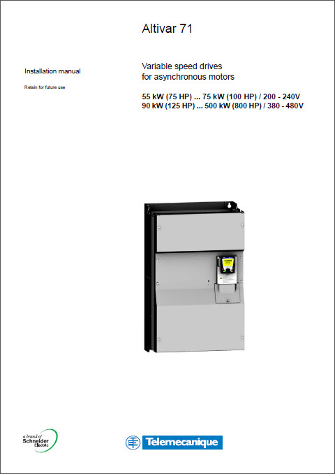

ALTIVAR 71 (ATV71HD) Variable Speed Drives for Asynchronous Motors (Installation manual)
Year: 2005
Author: Telemecanique
Genre: Installation manual
Publisher: Telemecanique (Schneider)
Number of pages: 53
Description:
55 kW (75 HP) ... 75 kW (100 HP) / 200 - 240V
90 kW (125 HP) ... 500 kW (800 HP) / 380 - 480V

Installation manual Retain for future use Altivar 71
Variable speed drives for asynchronous motors
