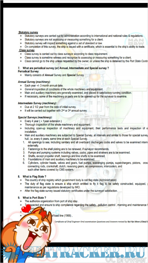

5. What is classification Survey ? 13
6. Why Classification Societies sometimes issue the Statutory Certificate? 13
Difference between : Statutory Survey and Classification Survey: 14
7. What are periodical survey (or) Annual, Intermediate and Special survey ? 14
8. What is Flag State ? 14
9. What is Port State ? 14
