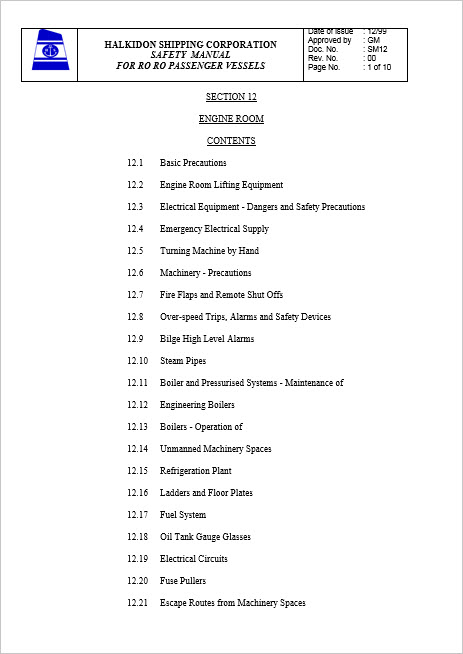

Halkidon shipping corporation safety manual for RO-RO passenger vessels
Year: 1999
Author: Halkidon shipping corporation
Genre: Safety manual
Publisher: Halkidon shipping corporation
Format: DOC
Number of pages: 10
Description: SECTION 12 ENGINE ROOM
Every dangerous part of a ship's machinery shall be securely guarded.
Before any repair or maintenance work is commenced care shall be taken by those in charge to ensure that all measures and precautions necessary for the safety of those concerned have been taken.
No maintenance work or repair which might affect the supply of water to the fire main or sprinkler system should be started without the prior permission of the Master and Chief Engineer.
Care should be taken to ensure that spare gear is properly stowed and items of machinery under repair are safely secured so that they do not break loose and cause injury or damage even in the heaviest weather.
No alarm system should be isolated without the permission of the Chief Engineer.
Fire fighting equipment, emergency escape routes and watertight doors should never be obstructed.
Spare gear, tools and other equipment or material should never be left lying around especially near to stabiliser or steering gear rams and switchboards.
A marlinespike, steel rod or other suitable device should be used to align holes in machinery being reassembled or mounted fingers should never be used.
When guards or other safety devices have been removed from machinery to facilitate the overhaul they should be replaced immediately the work is completed and before the machinery or equipment is tested.
Only intrinsically safe flashlights should be used for illuminating spaces where oil or oil vapour is present. Vapour should be dispersed by ventilation before work is done.
Always wear the necessary protective clothing and equipment appropriate for the work in hand e.g. goggles for grinding, hard hats where there is a risk of failing objects.
CONTENTS
12.1 Basic Precautions
12.2 Engine Room Lifting Equipment
12.3 Electrical Equipment Dangers and Safety Precautions
12.4 Emergency Electrical Supply
12.5 Turning Machine by Hand
12.6 Machinery Precautions
12.7 Fire Flaps and Remote Shut Offs
12.8 Over speed Trips, Alarms and Safety Devices
12.9 Bilge High Level Alarms
12.10 Steam Pipes
12.11 Boiler and Pressurised Systems Maintenance of
12.12 Engineering Boilers
12.13 Boilers Operation of
12.14 Unmanned Machinery Spaces
12.15 Refrigeration Plant
12.16 Ladders and Floor Plates
12.17 Fuel System
12.18 Oil Tank Gauge Glasses
12.19 Electrical Circuits
12.20 Fuse Pullers
12.21 Escape Routes from Machinery Spaces
12.22 Soot Blowing
12.23 Engine Room Pollution Precautions & Procedures
More...
