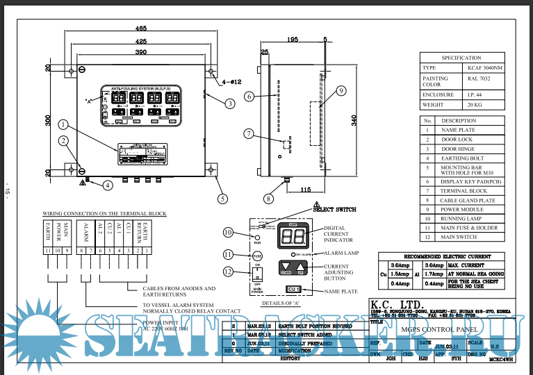

Anti-fouling System ( M.G.P.S) for 3,600 TEU Container Carrier
Year: 2012
Author: K.C. Ltd
Pages count: 21
Description: The fouling problem arises when barnacles, mussels and other lower forms of marine life as larvae enter pipework systems and settle on the internal surface of pipes where they rapidly grow and multiply.
In the most extreme cases, complete seawater lines can become blocked, affecting the safety and operational capability of the ship.
In other instances, the gradual restriction in the flow of seawater through cooling systems can impair engine efficiency, leading to increased fuel usage.

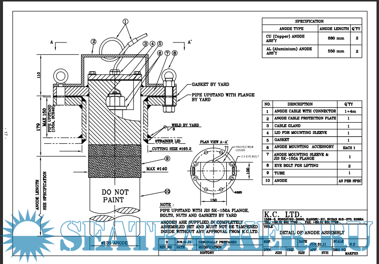

K.C. system is based on the electrolytic principle and consists of copper, aluminium and ferrous anodes which are fed with an impressed electrical current from a control panel.

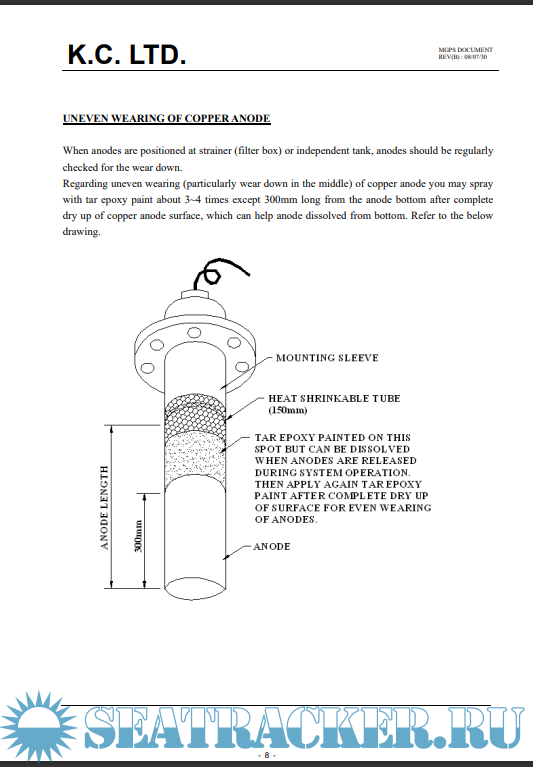

The anode are usually mounted in pairs in the ship’s sea chest or strainer where they are in direct contact with the flow of water entering the seawater lines.
Also the anodes can be mounted on independent treatment tank for other convenience.
In operation, the copper anode produces ions which are transported by the seawater and carried into the pipework system and equipment beyond.
Although the concentrations of copper in solution are extremely small i.e. less than 2 parts per billion they are sufficient to prevent marine life from setting and multiplying.
At the same time, the slow dissolution of the aluminium / ferrous anode produces ions which spread throughout the system and produce an anti-corrosive layer on the internal surface of pipes.
In this way, the anti-fouling system gives complete and continuous protection to pipework,valves and condensers as well as vital firefighting equipment, refrigeration and air conditioning unit.​
