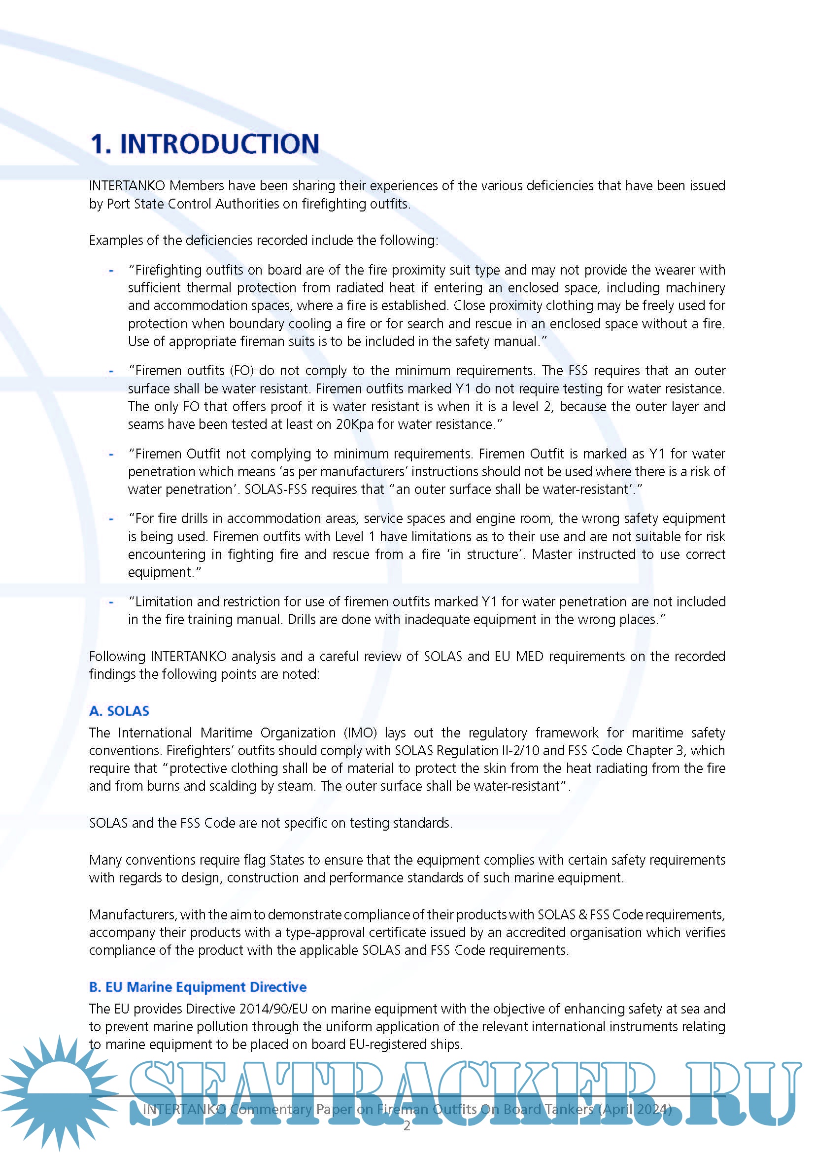

Description: INTERTANKO Members have been sharing their experiences of the various deficiencies that have been issued by Port State Control Authorities on firefighting outfits.
Examples of the deficiencies recorded include the following:

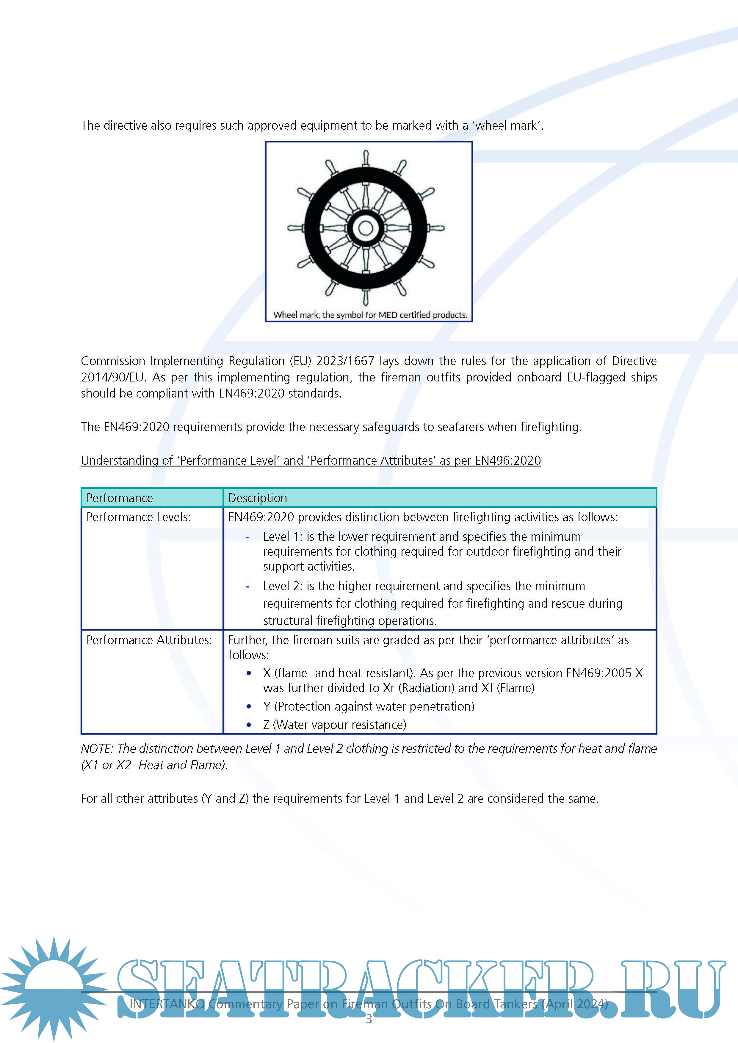

- “Firefighting outfits on board are of the fire proximity suit type and may not provide the wearer with sufficient thermal protection from radiated heat if entering an enclosed space, including machinery and accommodation spaces, where a fire is established. Close proximity clothing may be freely used for
protection when boundary cooling a fire or for search and rescue in an enclosed space without a fire.
Use of appropriate fireman suits is to be included in the safety manual.”
- “Firemen outfits (FO) do not comply to the minimum requirements. The FSS requires that an outer surface shall be water resistant. Firemen outfits marked Y1 do not require testing for water resistance.
The only FO that offers proof it is water resistant is when it is a level 2, because the outer layer and seams have been tested at least on 20Kpa for water resistance.”
- “Firemen Outfit not complying to minimum requirements. Firemen Outfit is marked as Y1 for water penetration which means ‘as per manufacturers’ instructions should not be used where there is a risk of water penetration’. SOLAS-FSS requires that “an outer surface shall be water-resistant’.”
- “For fire drills in accommodation areas, service spaces and engine room, the wrong safety equipment is being used. Firemen outfits with Level 1 have limitations as to their use and are not suitable for risk encountering in fighting fire and rescue from a fire ‘in structure’. Master instructed to use correct equipment.”
- “Limitation and restriction for use of firemen outfits marked Y1 for water penetration are not included in the fire training manual. Drills are done with inadequate equipment in the wrong places.”
Additional info: Firefighting teams on board should be aware of the outfit limitations during onboard familiarisation.
These limitations should also be included in the ship-specific training manual and the record of
firefighting drills should not conflict with the limitations.
