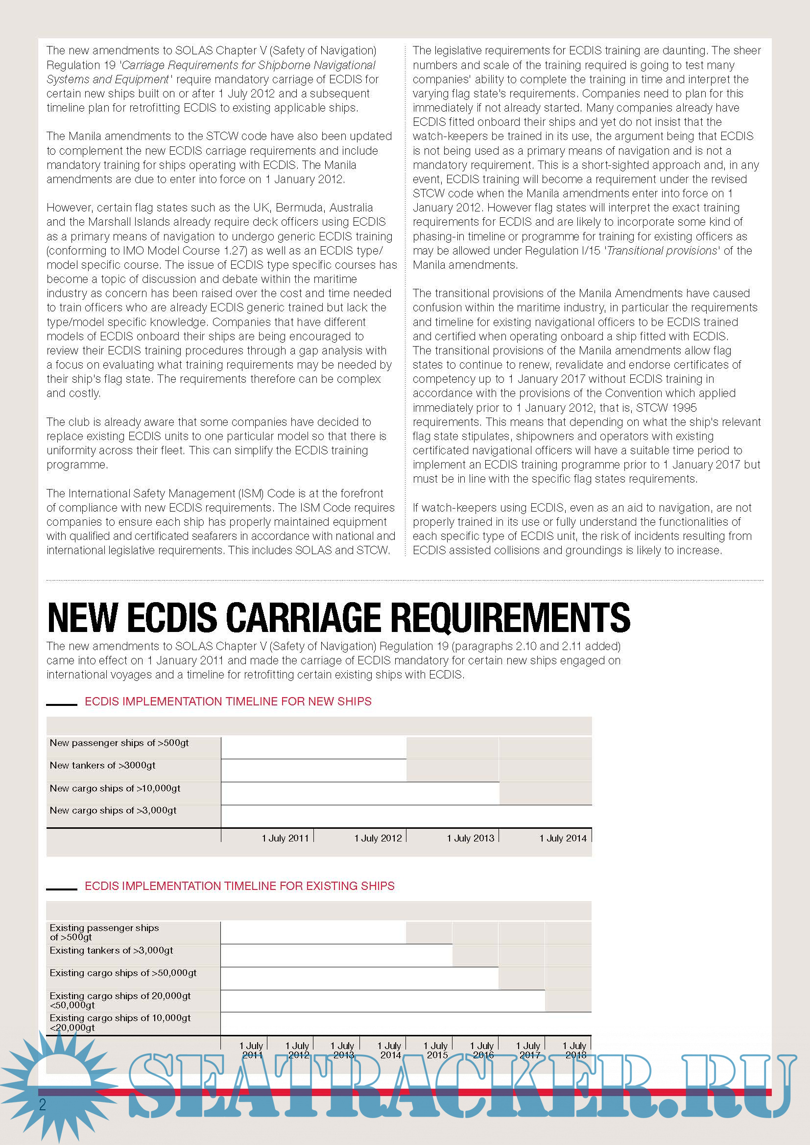

2 New ECDIS carriage requirements

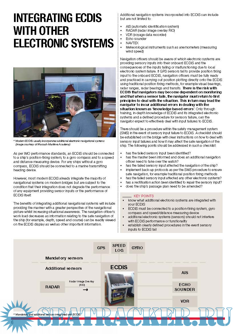

6 Integrating ECDIS with other electronic systems
