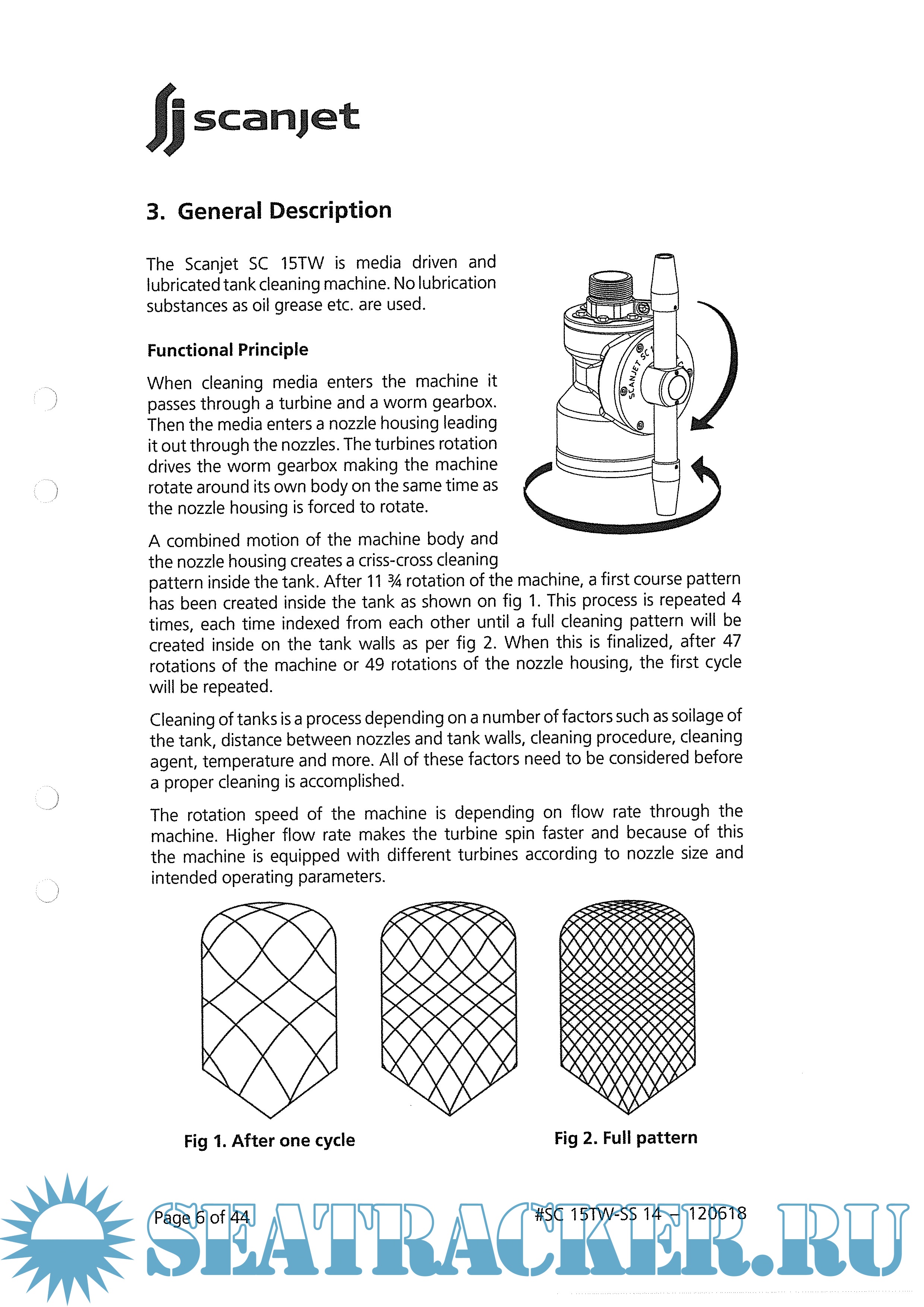

The cleaning procedure will start by open the valve for cleaning media. The
water flow will pass over a turbine inside the machine and the nozzles will
rotate creating a crisscross cleaning patten inside the tank. When the cleaning
procedure is finalized the valves are to be closed.

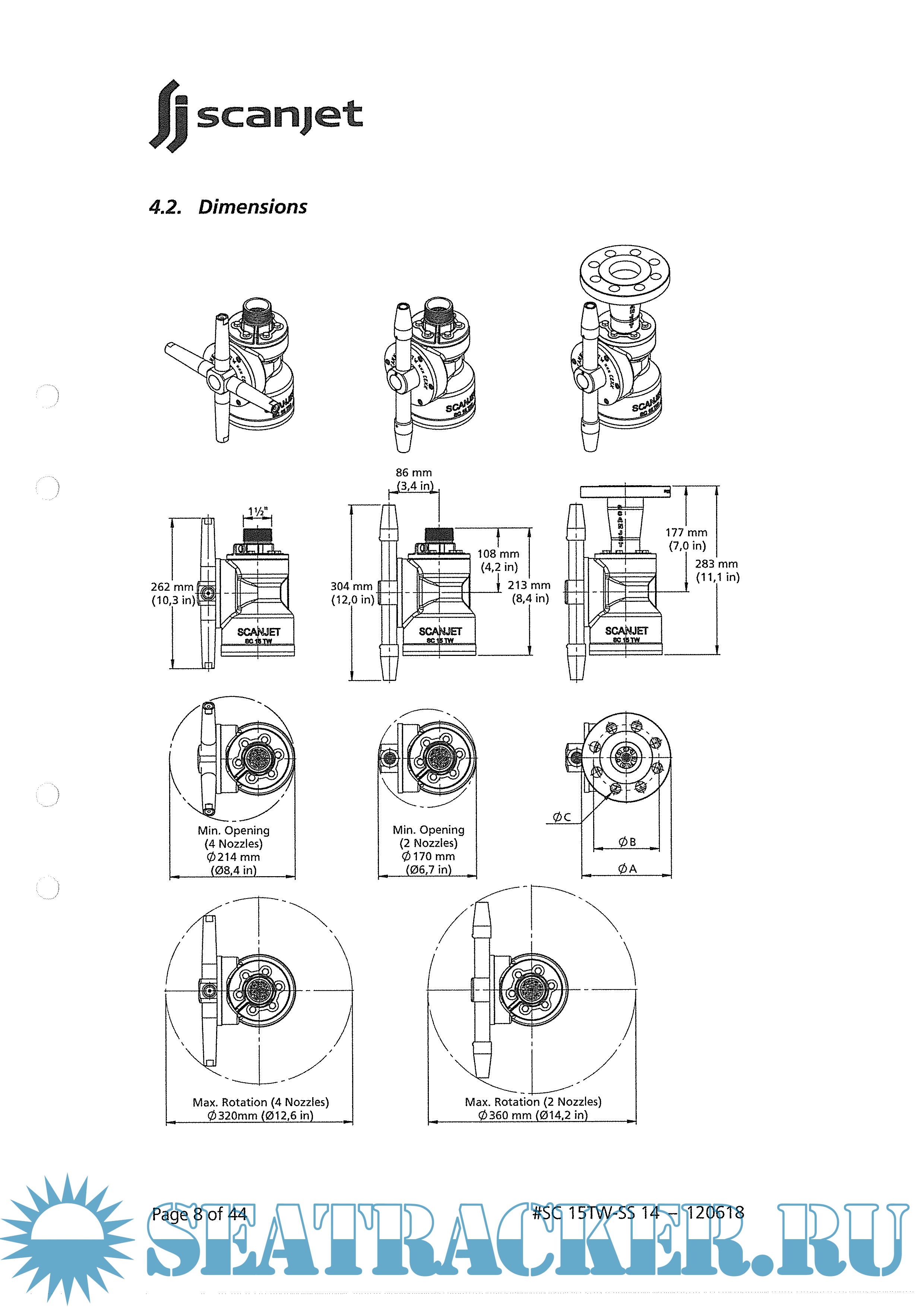

SC 15TW is as standard delivered with two or four nozzles, and nozzle sizes
between d6 mm and d10 mm.
