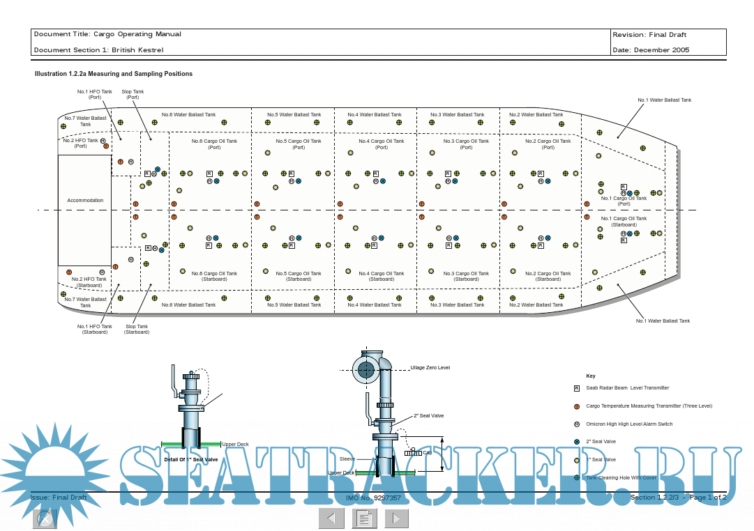

1.2.2a Measuring and Sampling Positions

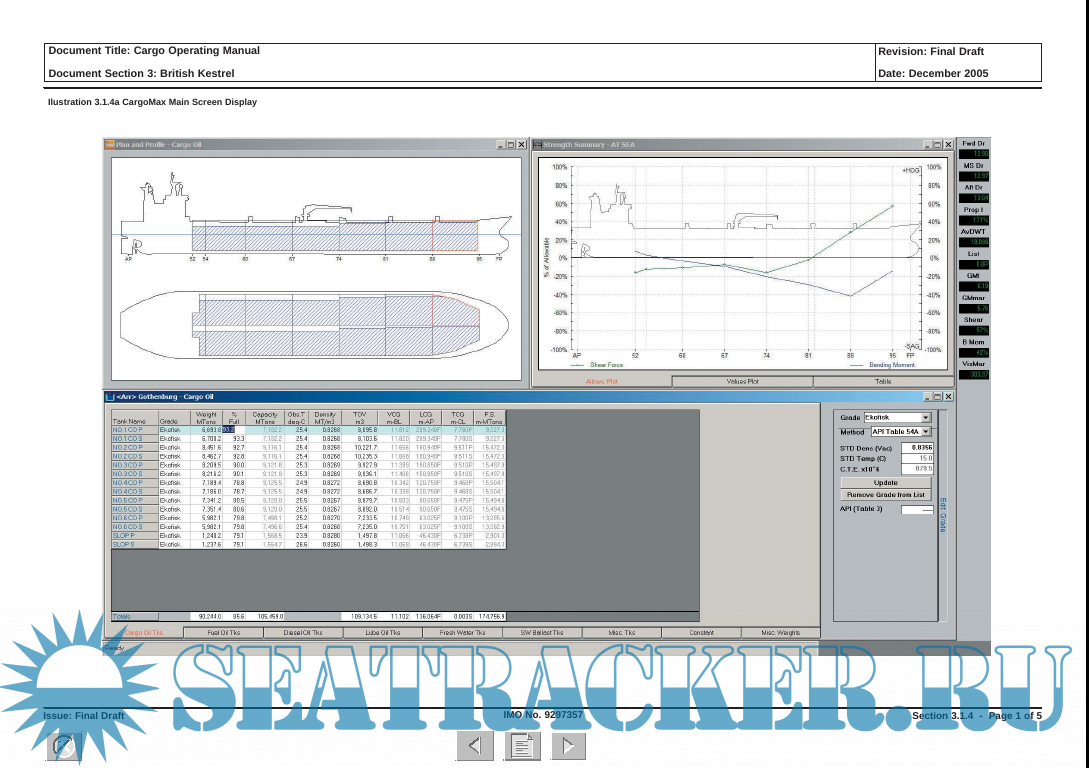

3.1.4a CargoMax Main Screen Display
3.1.4b CargoMax Ballast Screen Display

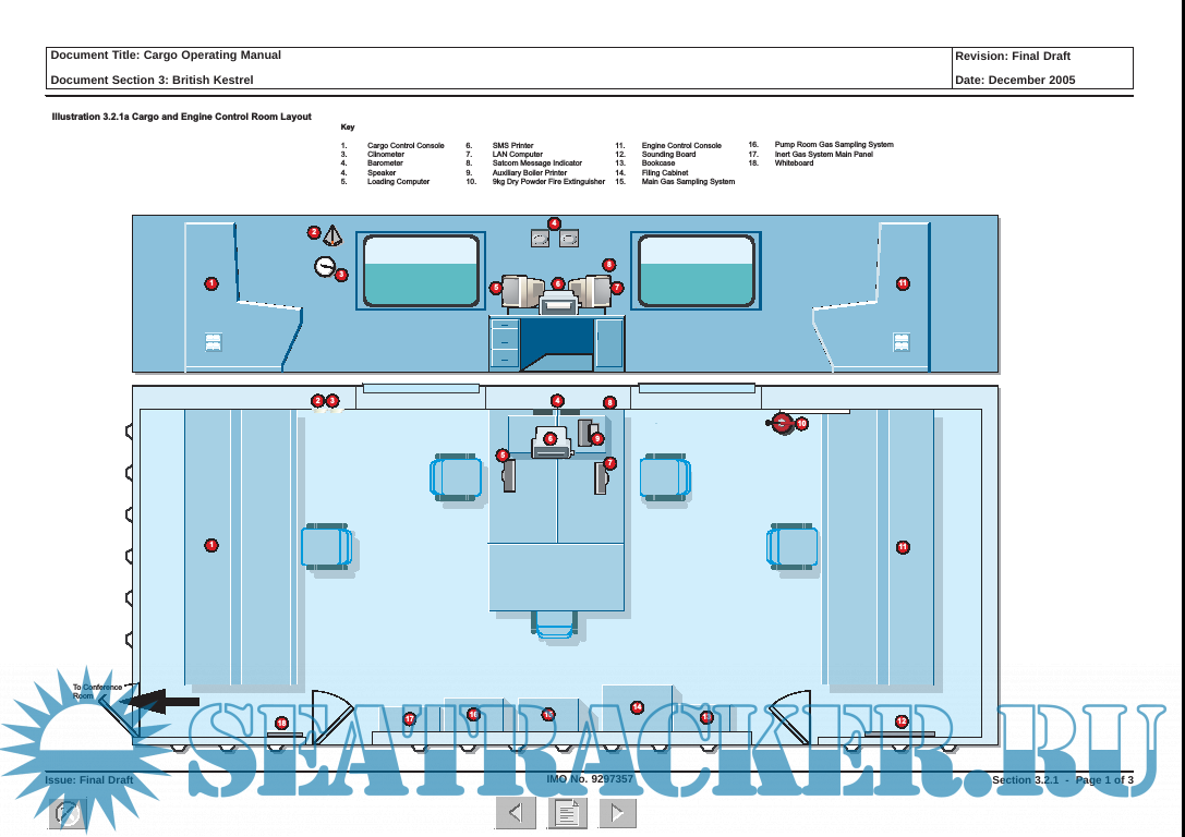

3.2.1a Cargo and Engine Control Room Layout
3.2.1b Cargo Control Room Console Layout
