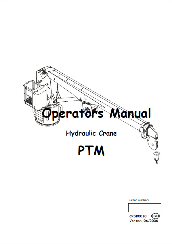

Hydraulic Crane PTM / Operators Manual
Year: 2006
Author: PALFINGER MARINE
Genre: Operating Manual
Series: 06/2006
Crane number:: CPDB0010
Quality: OCR without errors
Number of pages: 76
Description: This manual has been prepared by the machine manufacturer with the aim of providing information about safe operation of the equipment to the people who are authorized to carry out work procedures for transport, handling, installation, servicing, repair, disassembly and disposal of the crane.
Failure to observe the information can result in risks to the health and safety of people and in property damage.
This documentation should be given to a conscientious person for use as intended and for safekeeping at an appropriate location so that it is always available for reference and maintained in good condition.
If this documentation should be lost or damaged, request a replacement directly from your dealer, giving the identification code of the current manual.
The manufacturer retains the right to insert modifications, integrated material or improvements in the manual at any time; said insertions will not cause this publication to become unusable.
Symbols have been used to call your attention to especially important items in the text; their meaning is explained below. Are you from Australia? You are welcome! Download this file via torrent for free
An overhaul comprises replacement of bearings and/or other mechanical components which display so much wear and tear that the operation of the crane is adversely affected. In addition, an overhaul includes a check of all of the crane components (gaskets, washers, deaeration valves, etc.). These materials must be disposed of in conformity with applicable environmental protection laws.
