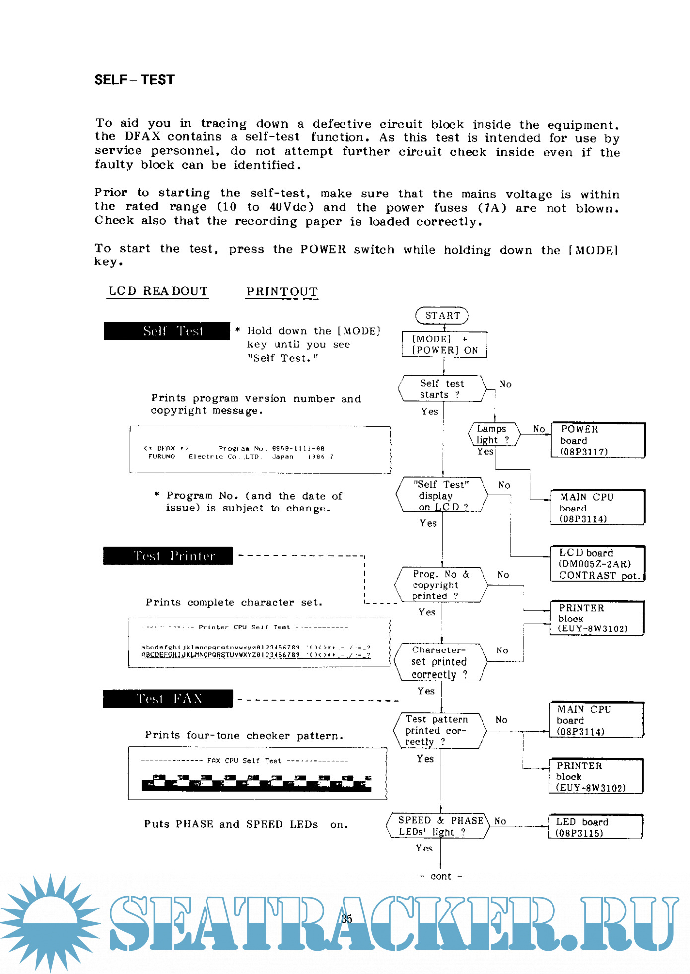

Arcan ®   30-Jan-2018 18:58
Furuno FAX-208/A/N Operators Manual
Year: 1994
Author: Furuno
Publisher: Furuno
Edition: T
Pages count: 71
Description: The DFAX (FAX-208 series) is just one of the many Furuno developments in the field of marine radio communication.
Furuno is known as the first manufacturer of a single stylus all station-programmed facsimile receiver models FAX-108/14311.
Your DFAX is loaded with various features; quet thermal recording, fully-automatic operation, Navtex reception capability, affordable price range, etc. (Imagine, four microprocessors are working in the small cabinet)
Furuno 208 A/N Facsimile Receiver
DFAX : Dual Function Fax Rx
Model : FAX-208/A/N
(FAX-208 Navtex unavailable)
(FAX-208A Navtex Option)
(FAX-208N Navtex Built In)
Furuno FAX-208A_N Operators Manual
