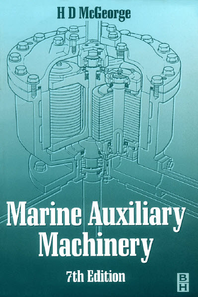

Marine Auxiliary Machinery 7-edition
Year: 1995
Author: McGeorge H. D.
Publisher: Great Britain by MPG Books Ltd
ISBN: 0 7506 4398 6
Number of pages: 525
Description: The preparation of the seventh edition of this established book on marine auxiliary machinery has necessitated the removal of some old material and the inclusion of new topics to make it relevant to the present day certificate of competency examinations. It is hoped that the line drawings, many of which were provided by Mr R. C. Dean, a former colleague in London, will be useful for the certificate of competency and other examinations. The majority of other illustrations and much of the basic text have been provided over the years by the various firms listed in the Acknowledgements. I am grateful to those firms who have supplied me with material added in this edition.
