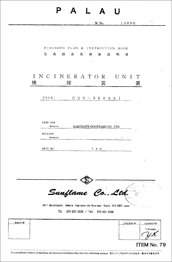

zxc ®   05-Nov-2012 12:51
Incinerator Unit Type : OSV— 360SAI - Palau / Finished plan & instruction book
Year: 2003
Author: P A L A U
Genre: INSTRUCTION BOOK
Publisher: HAKODATE DOCKYARD CO., LTD.
Number of pages: 88
Description: We are very happy with your adoption of the product of Sunflame make.
We will take a) 1 effort lo your satisfaction, and hope to hold a long relationship between us while the equipment is at your service regularly.
The instruction manual here is written for instructing how to use the equipment with full ability in safe. Please keep the manual with good care so that every person who handle or manage the equipment can study it at his convenience.
Labels and plates arc on the equipment in order lo call your at tent ion for safety. Keep them c lean, and rep 1 ace unclean one.
The equipment is obviously put in service for burning purpose. Please handle the equipment with sufficient care of safety, upon a studying to understand properly of the manual document and the label descriptions. A careless or vrong handling may resuli a serious siluation or accident including explosion, fire, death, injury or illness.
The following notations are for cal3 ing your attention to a danger situation by a level, which may occur from a wrong handling.
The levels are classified in common sense, and they don’t mean their seriousness are 1 i mi ted wi thin their level. DANGER! A situation with death, serious injury or illness, explosion or fire
The equipment is guaranteed for a year after being handed over without otherwise specified.
An accident or trouble which is resulted from some careless or wrong handling is out of our responsibility.
You can contact us at the following address for your inquiry of some ordering of part, some unclear matter in the manual, some question about•equipment and so on.
Please refer us to the model no., the mfg. no., the necessary parts, the builder and their construction no. (ship no.) and the detail situation of the machine at the inquiry.
