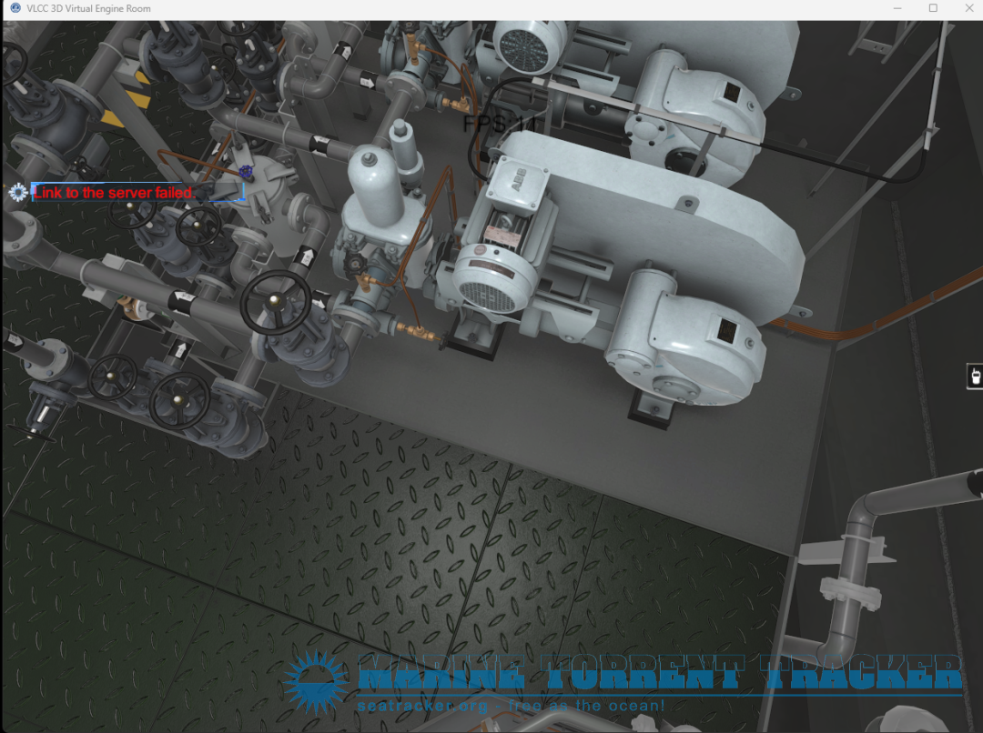

This is the stable VLCC-A simulator package, including both the 2D and 3D terminals. The 2D terminal is fully functional and should work without any significant issues. The 3D terminal also works correctly, but you may encounter some network configuration issues when trying to connect it to the simulator manager (M terminal).
If you have any problems establishing the network connection between the 3D terminal and the simulator manager, feel free to ask for help here in comments. I will do my best to help you troubleshoot it.
I successfully patched the 3D and M terminals using dnSpy, so they should normally work correctly with the DMSCTS environment.

  • If the terminals fail to connect and you receive a message such as “Server Link Failed”, you can ask for help here.
Network configuration may sometimes be required depending on your computer and DMSCTS setup.

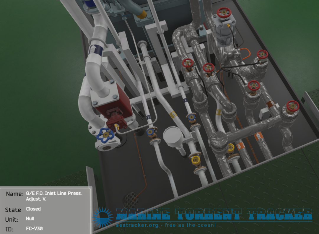

sonadoer   31-Aug-2026 02:55
Can anybody help me figure out the boilers. I want to start it in de 2d system but it keeps doing a flame out. In the start up procedure while doing ignition stage it doesnt open the fuel valves. Is that some kind of bug or am i missing something? Is there any manual as well or?
