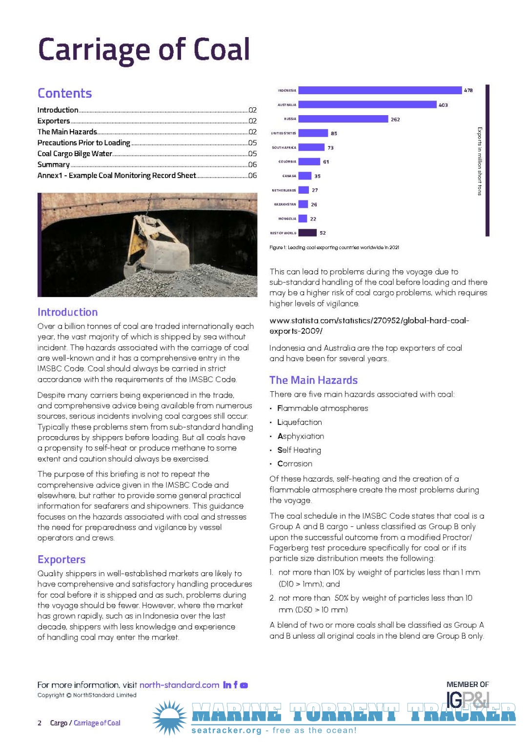

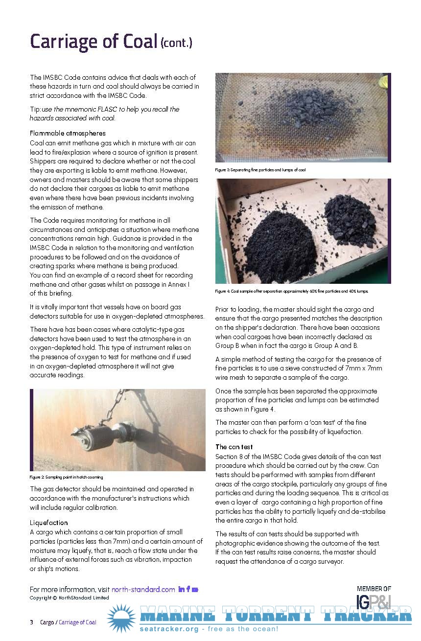

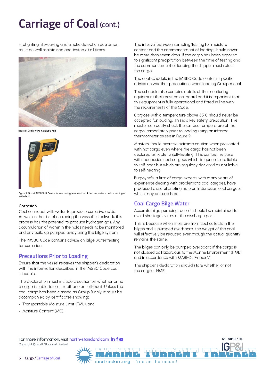

Description: Over a billion tonnes of coal are traded internationally each year, the vast majority of which is shipped by sea without incident. The hazards associated with the carriage of coal are well-known and it has a comprehensive entry in the IMSBC Code. Coal should always be carried in strict accordance with the requirements of the IMSBC Code.
This guidance focuses on the hazards associated with coal and stresses the need for preparedness and vigilance by vessel operators and crews.
