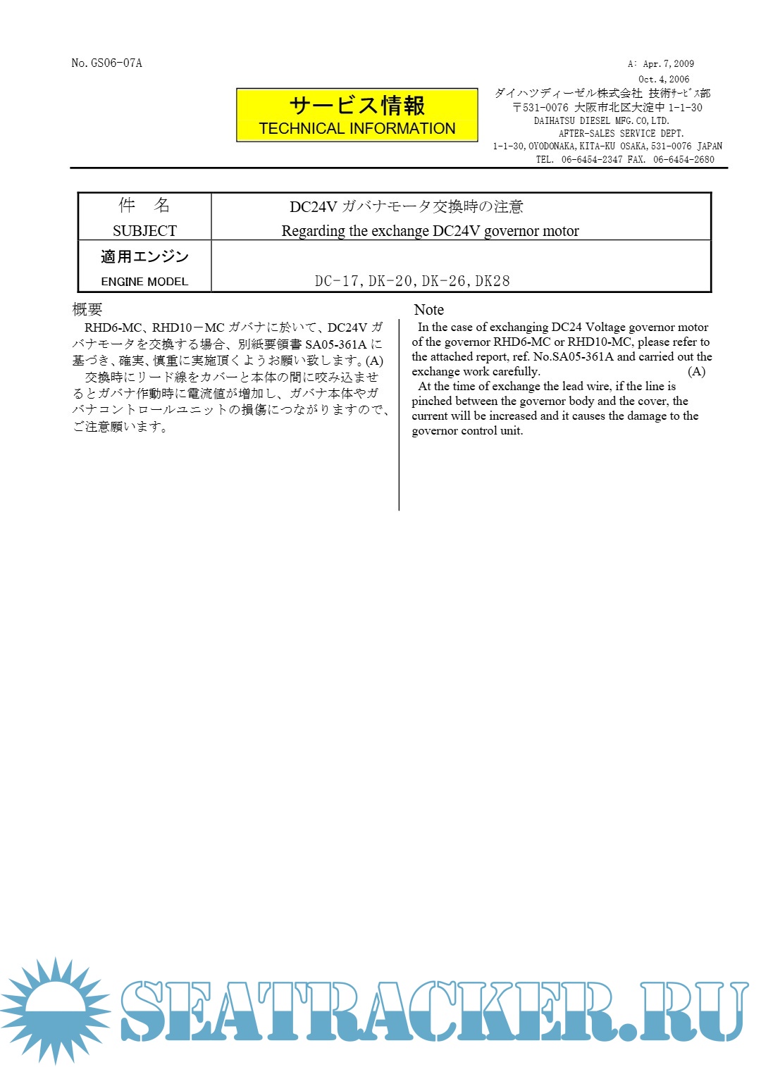

TECHNICAL INFORMATION Regarding the exchange DC24V governor motor
Year: 2009
Author: DAIHATSU DIESEL MFG.CO,LTD.
Number of pages: 5
Description: TECHNICAL INFORMATION Regarding the exchange DC24V governor motor. In the case of exchanging DC24 Voltage governor motor of the governor RHD6-MC or RHD10-MC, please refer to the attached report, ref. No.SA05-361A and carried out the exchange work carefully. (A) At the time of exchange the lead wire, if the line is pinched between the governor body and the cover, the
current will be increased and it causes the damage to the governor control unit.
