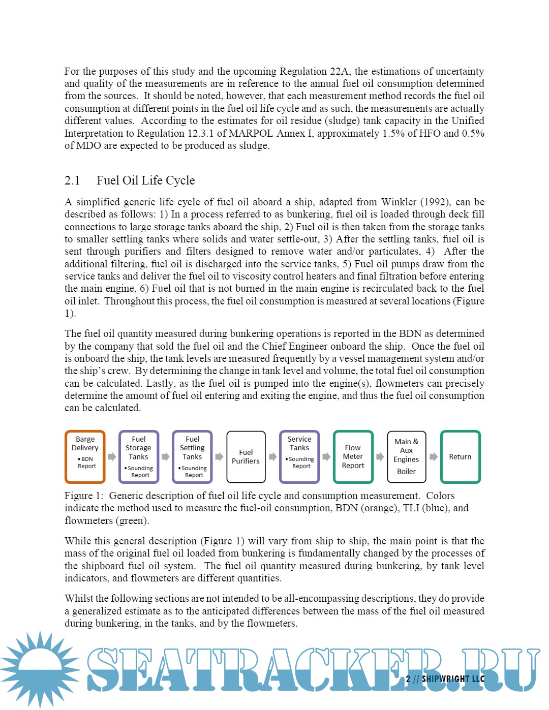

The three most widely used methods for collecting data on annual fuel oil consumption are the bunker delivery note (BDN), monitoring tank level indicators (TLI), and using flow metering. The IMO convened this study to examine the uncertainty for each of these methods.

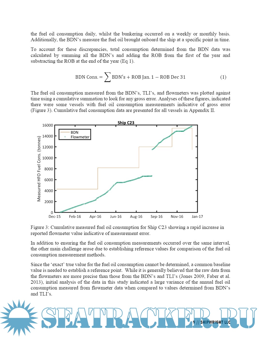

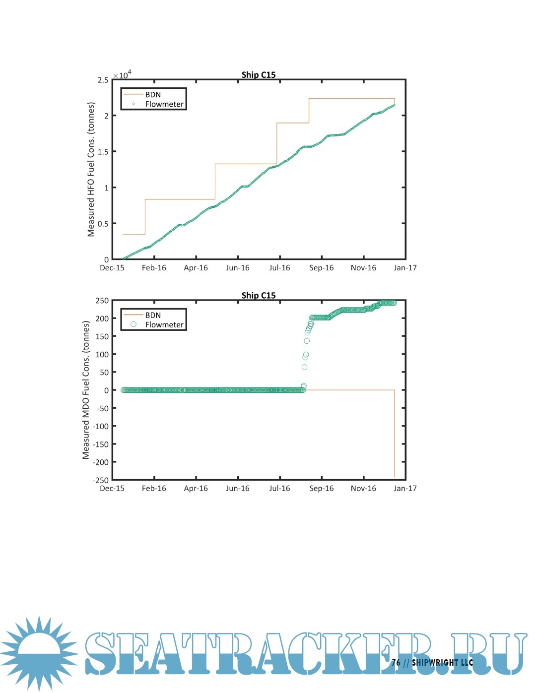

1. Annual fuel oil consumption determined from BDN and TLI data were in close agreement; whereas, the values determined from flowmeter data were systematically lower with the differences larger than what can be reasonably associated with fuel oil processing. The relatively large variance of the flowmeter data when compared to the BDN and TLI data suggest that the flowmeter data contain considerable amounts of random error.
2. An uncertainty analysis at a 95% confidence interval estimated that for all of shipping, the annual HFO fuel consumption determined from TLI and flowmeter data would have the following differences when compared to BDN data.
• TLI: 0.33% ± 1.8%
• Flowmeter: -12% ± 6.5%
It is unknown if the relatively poor agreement of the flowmeter data in comparison to BDN and TLI sources are a coincidental artifact unique to these companies or if these findings are emblematic of accuracy problems observed in other types of shipboard data.
