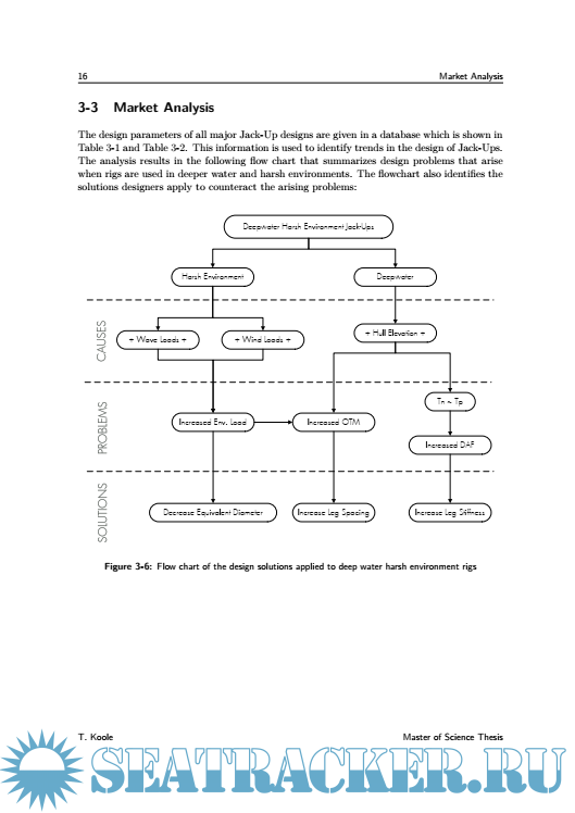

A market analysis identifies the trends within Jack-Up designs which can be used to generate the models used in the main body of this research. Quasi-static environmental loads are analysed to investigate the effects of using Jack-Ups in greater water depths. The dynamic response is then added as Jack-Ups are known to show significant dynamic behaviour. Timedomain FEM is used as it allows for the incorporation of the non-linearities that are present in the system. The final chapters of this thesis focus on the future of Jack-Up design. Firstly, the limits of the current design philosophy are identified. Secondly, four possible solutions to overcome these boundaries are proposed and briefly analysed to evaluate their potential.

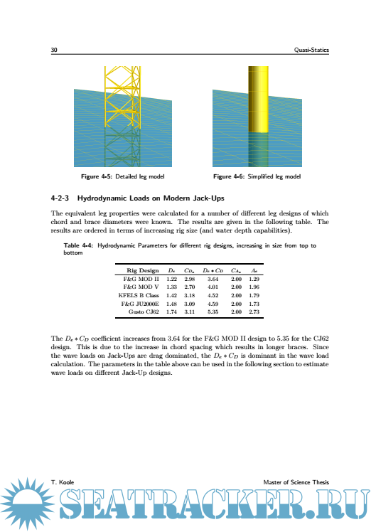

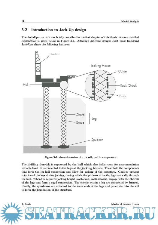

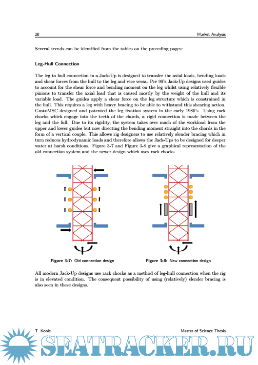

This thesis has shown that modern Jack-Ups are characterised by large triangular hulls, holding three spacious truss legs. Rack-chocks form a very stiff leg-hull connection which has allowed designers to reduce brace diameters and increase chord spacing. This has lead to an increase in problems associated with Rack Phase Difference. Wind loads increase significantly with these modern rig designs but wave loads remain fairly unchanged due to increased leg spacing. Modern Jack-Ups therefore become more wind-dominated when compared to older designs. This stresses the need for accurate calculation of wind-loads during JackUp assessment. The dynamic response analysis and its non-linearities remain to play an important role in the assessment of the structure. Significant dynamic amplification of the oscillating wave loads is found. The future of the current Jack-Up design philosophy is limited to approximately 200 meters. As hull weights and water depths increase, a strong increase in leg stiffness is required to prevent resonance from occurring. Fabrication and operational limits prevent the stiffness from increasing further. Solutions to overcome these boundaries show the difficulties of designing hybrid structures like Jack-Ups; improvements made in one area will often lead to compromises being made in another.
