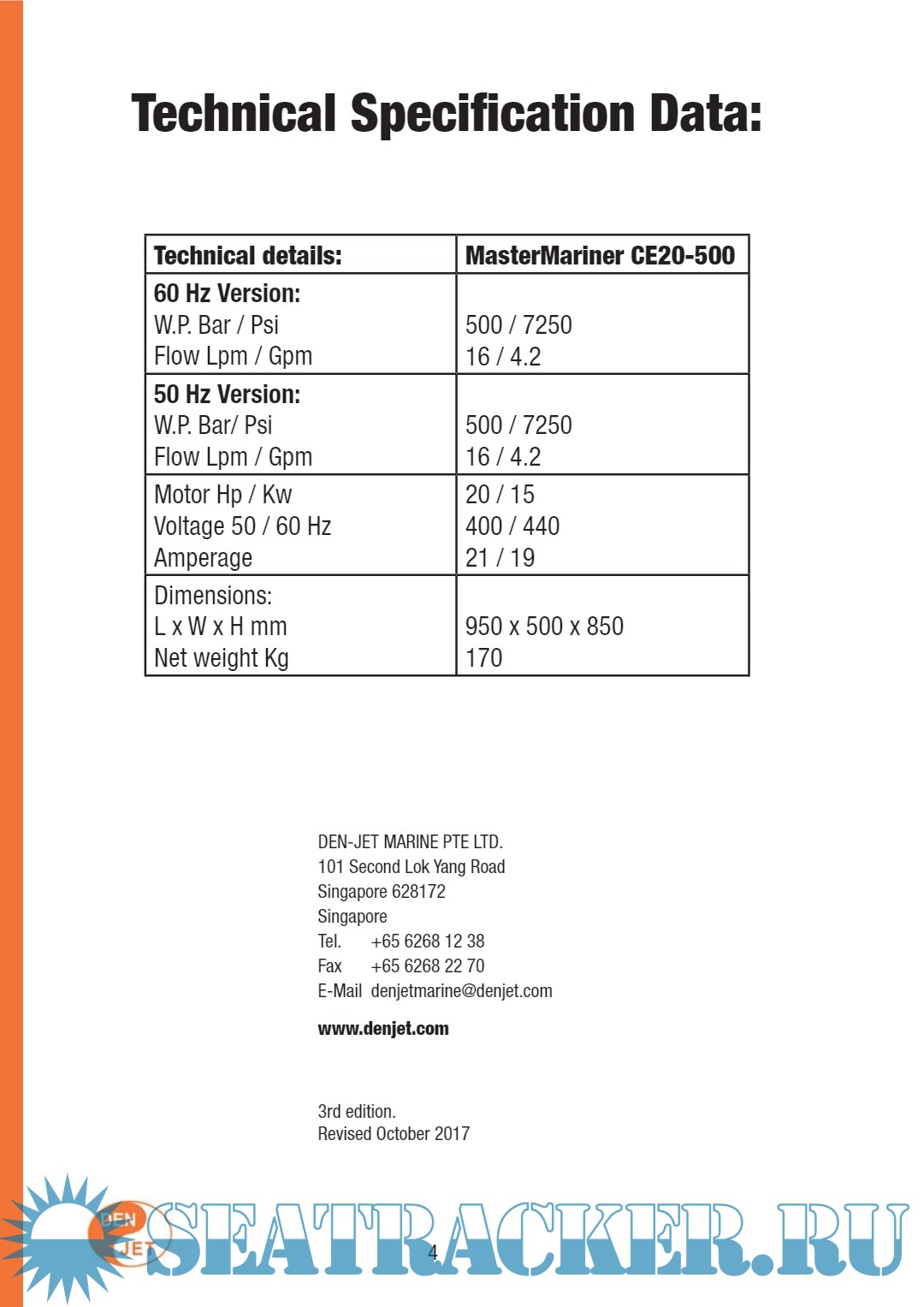

Description: DEN-JET CE20-500 WATERBLASTER (MasterMariner500/7250 psi) manual describes the operation procedure of the equipment including corrosion
management , surface preparation and operational PPE.
