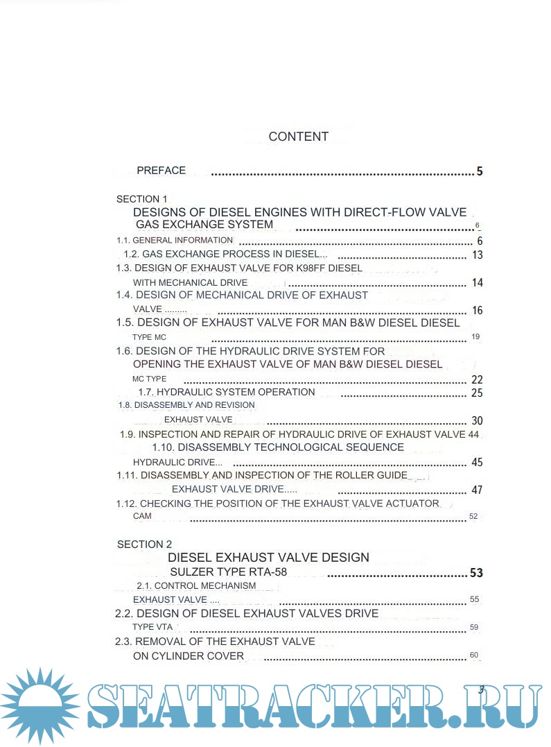

Diesel Exhaust Valves
Year: 2007
Author: V.P. Smirnov
Genre: Technical book
Publisher: Association of Marine Mechanical Engineers
Pages count: 100

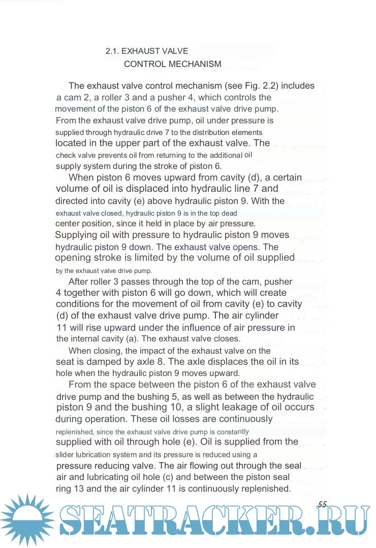

Description: The book examines the main unit of the direct-flow valve gas exchange system of main engines - the exhaust valve.
The designs of exhaust valves of such such engines as B&W, MAN B&W, Sulzer RTA, their operating and control conditions, inspection and repair are described.
The issues of carbon formation on valve plates and the mechanism of damage and destruction of exhaust valves are considered. The book is intended for a wide range of ship mechanics operating the main engine, as well as for the students of advanced training courses.
Additional info: Screenshots translated from russian to english and then compiled into a book for the benefit of english-speaking members of the forum. Apologies for the quality - it's unavoidable in the process of scanning and translating.
Download [6 KB]
