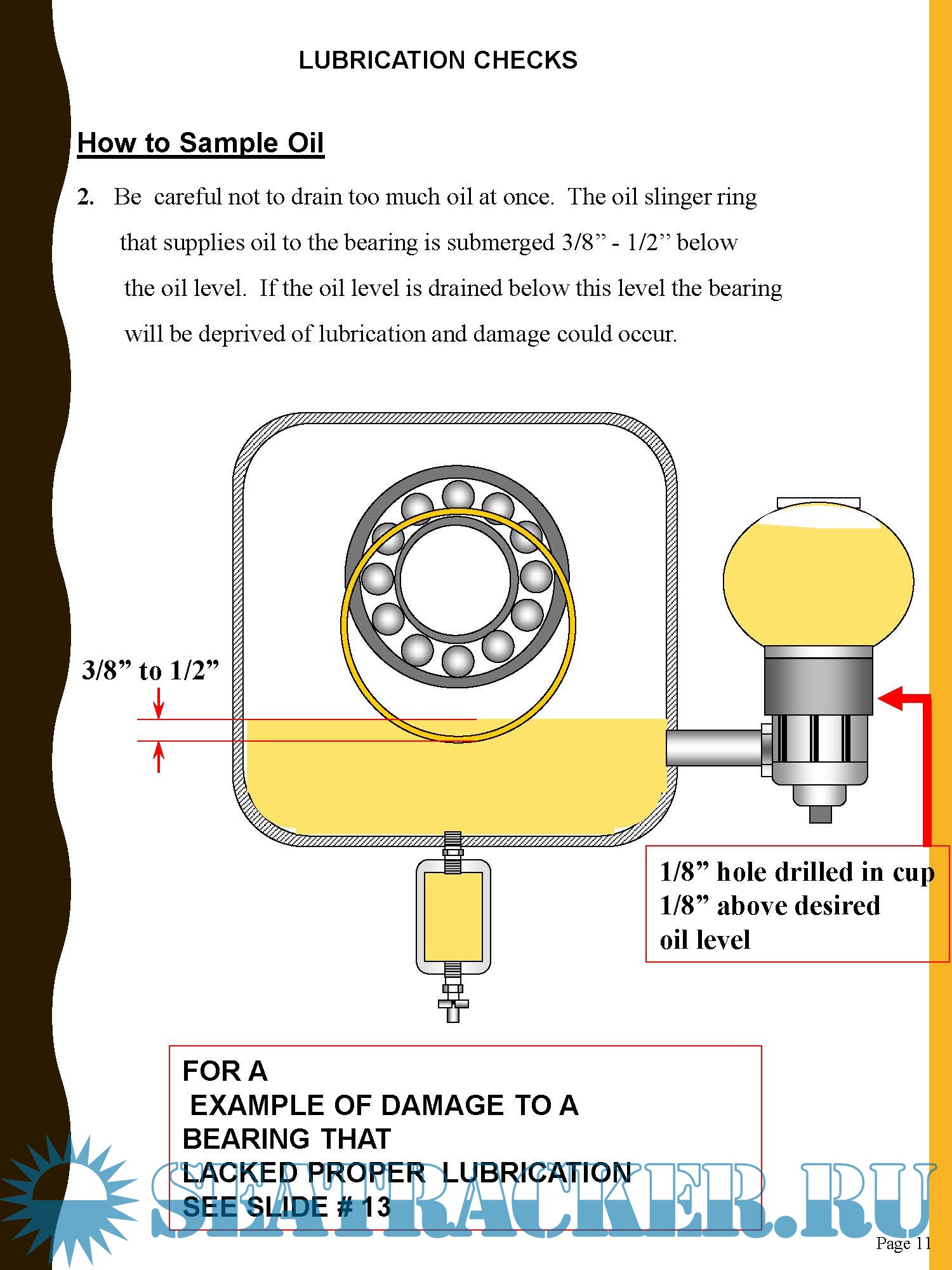

•Constant Level Lubrication
Oil level is maintained in a bearing housing
and delivered to bearings via lube oil rings which
rotate with the shaft or in some applications
the rolling element is partially submerged in oil

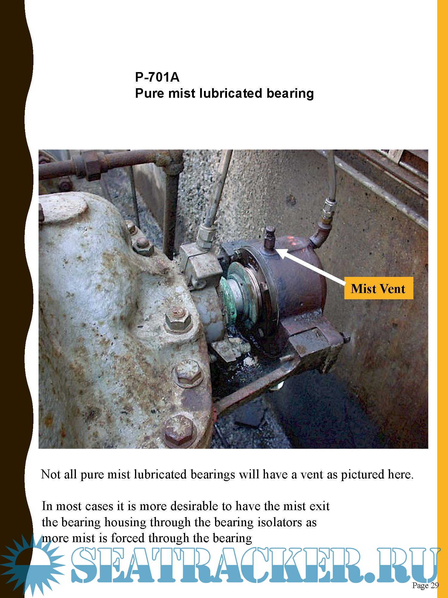

•Pure Mist Lubrication
Provides an atomized oil environment to wet and lube
rolling elements
Only used on rolling element bearings
Never on Babbitt, Liquid film bearings
