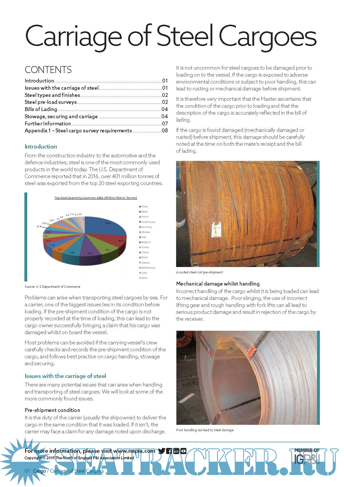

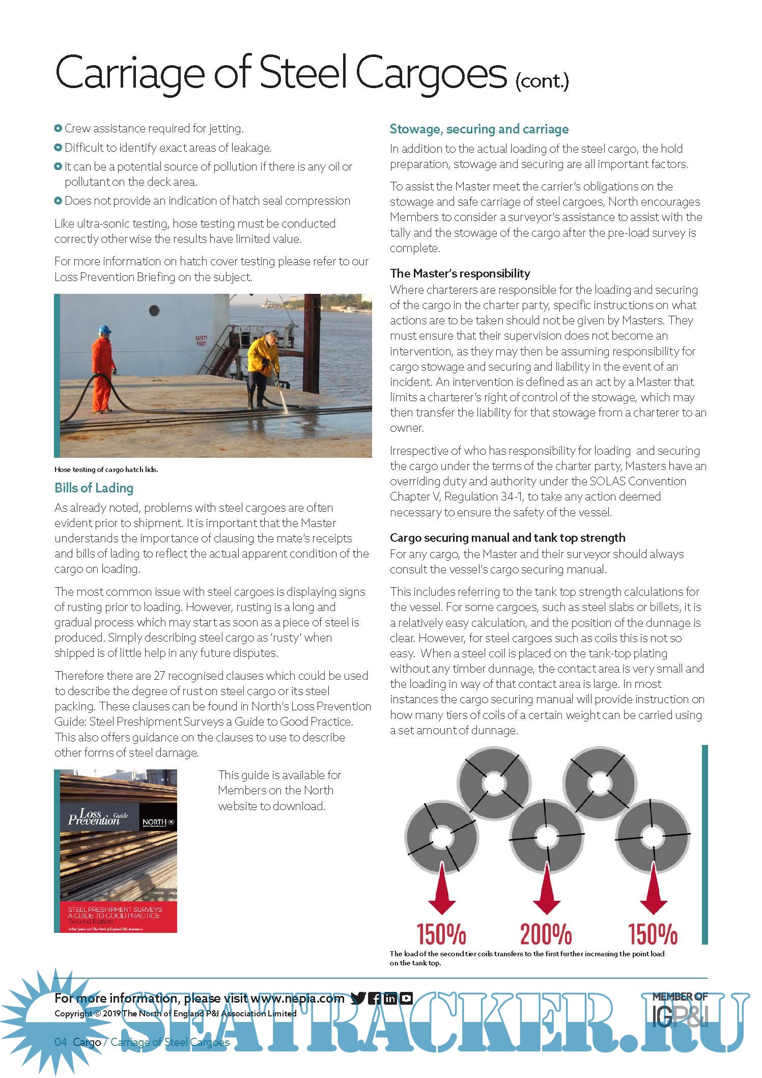

Description: Problems can arise when transporting steel cargoes by sea. For a carrier, one of the biggest issues lies in its condition before loading. If the pre-shipment condition of the cargo is not properly recorded at the time of loading, this can lead to the cargo owner successfully bringing a claim that his cargo was damaged whilst on board the vessel.
Most problems can be avoided if the carrying vessel’s crew carefully checks and records the pre-shipment condition of the cargo, and follows best practice on cargo handling, stowage and securing.
