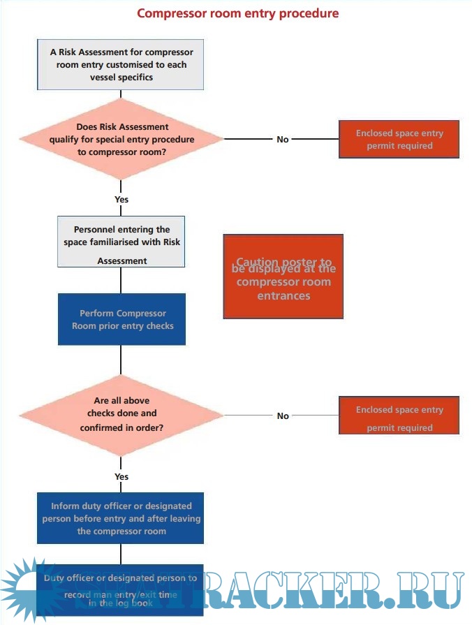

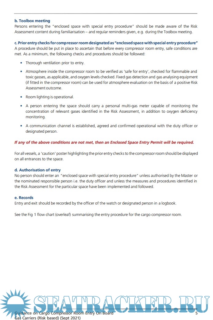

This Guidance proposes a risk-based method to control compressor room entry without lowering safety
standards.

The International Code of the Construction and Equipment of Ships Carrying Liquefied Gases in Bulk (IGC
Code) specifies the requirement for a cargo compressor room's ventilation, openings for entry and exits, and
gas detection system. These IGC requirements may allow some cargo compressor rooms to be dealt with as
"enclosed spaces with special entry procedure" - as they have permanent and appropriate fixed mitigations
in place.

advice on the safety measures to be put in place when entering cargo compressor rooms that have been
risk assessed for entry without the need for an Enclosed Space Entry Permit, in other words, deemed as
"enclosed spaces with special entry procedure". The scope of the document is limited to guidance on the
cargo compressor room entry procedure.
