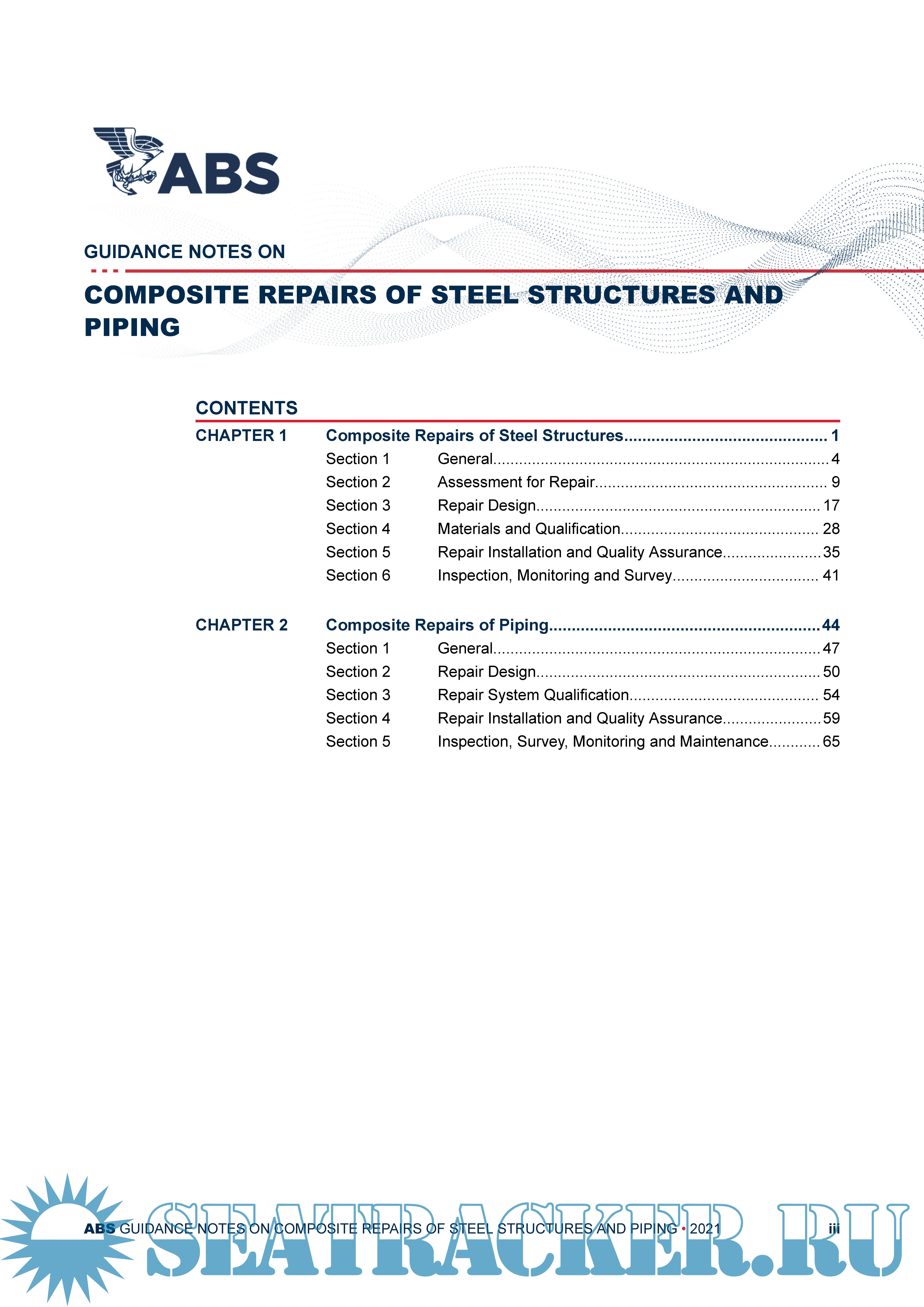

Guidance Notes on Composite Repairs of Steel Structures and Piping
Year: 2021
Author: ABS
Pages count: 71
Description: This Chapter is applicable to the use of composite repairs on site-specific offshore units such as FPSOs and
FSOs. It provides guidelines on adhesively bonded composite repairs of the steel structures. It covers
assessment, design, qualification, installation and inspection of a bonded repair.
This Chapter does not cover aluminum structures, even though this guidance may also be applicable to
aluminum structure repairs.
These Guidance Notes provide an alternative to regular hot work renewal, where the hot work is
considered risky to the offshore unit´s operation. Instead of using hot welding, an existing degraded steel
structure can be repaired to restore the integrity of the structure by utilizing patches of composite material,
steel plates, or other structural materials that are bonded to the degraded steel structure.
