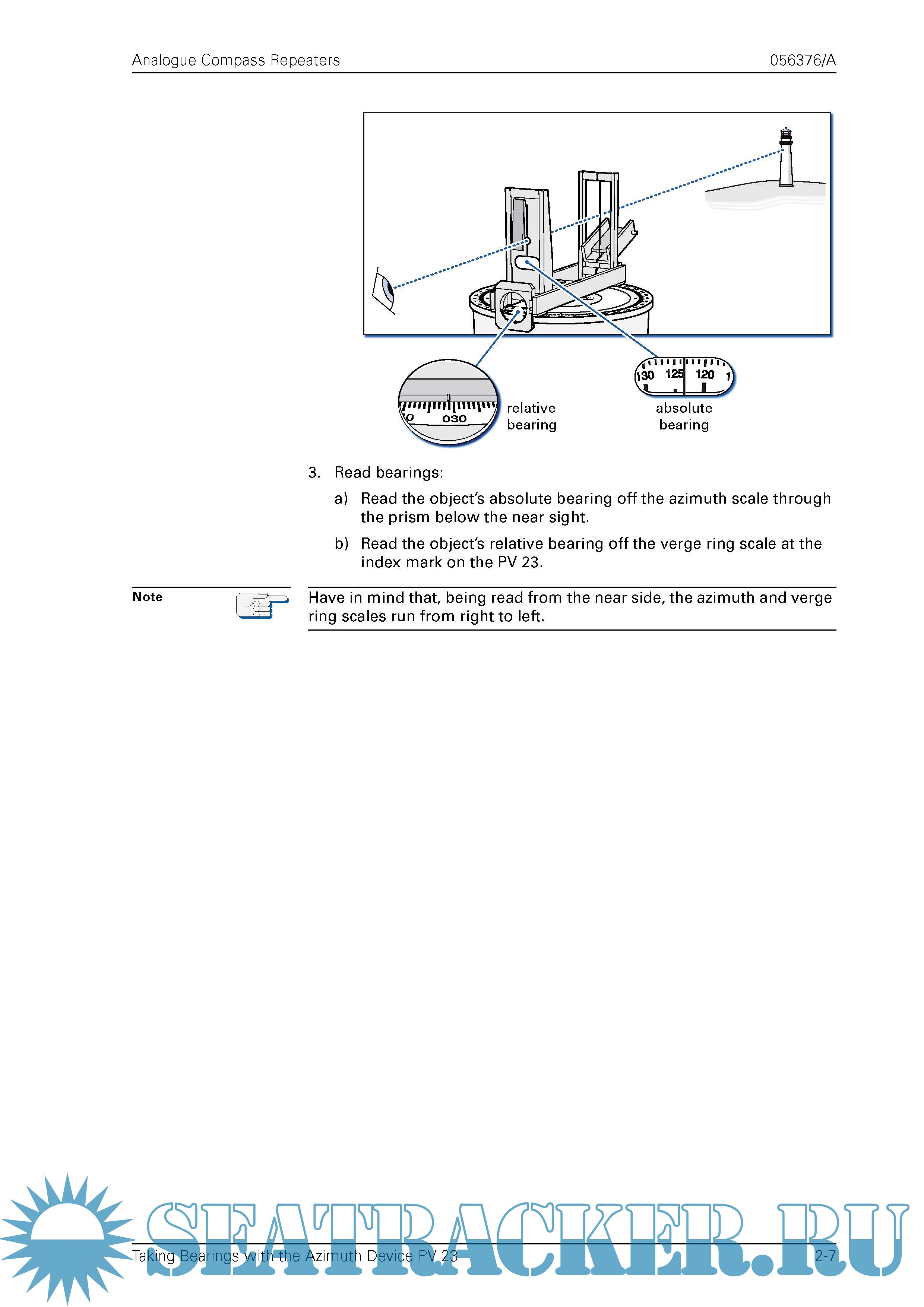

The prismatic azimuth device PV23 is a classified compass bearing device designed for usage together with the bearing repeater 5016-CA.
