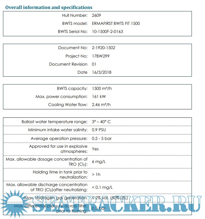

The ERMA FIRST BWTS system developed by ERMA FIRST S.A. is autonomous, modular and reliable for
the treatment of ballast water, with respect to the D-2 standard of the International Convention for
the Control and Management of Ships’ Ballast Water and Sediments.
Additional models were added in order to exceed all the special installation requirements either for
New Building vessels or especially any retrofit project.
During ballasting, the incoming/ upcoming water goes through filtration, to remove particles and
organisms larger than 40 microns. The filtered water will then enter the electrolysis module where
the remaining viable organisms will be eliminated.
During de-ballasting, the system main components are by-passed while the neutralization module is
operating. Water is discharged overboard -after neutralization.
Ιsokinetic G2 sampling port is placed on the discharge line enabling authorities to sample treated
ballast water prior to discharge and verify BWTS operation and efficiency.

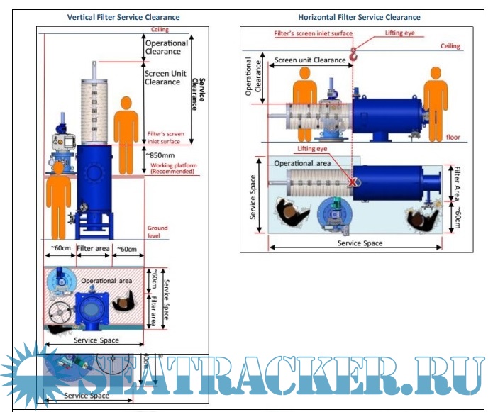

5.1 FILTER
5.1.1 Normal Flow Pattern
5.1.2 Flushing Cycle
5.1.3 Service Clearance Guidelines
