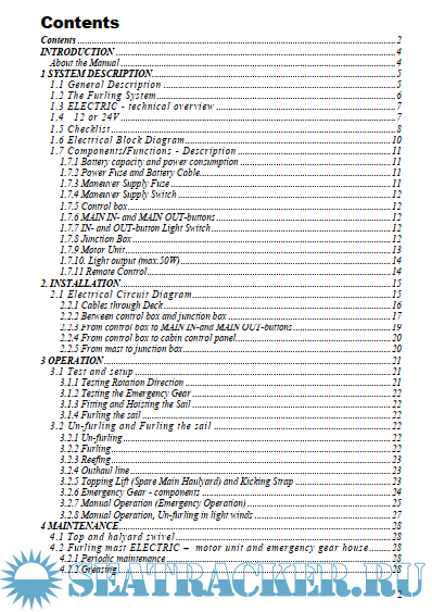

The manual is divided into four sections. One is a GENERAL DESCRIPTION of the system and of
the included electrical and mechanical parts. The second section is dealing with INSTALLATION (the
electrical components) of a system mounted on a new furling mast, and the third one describes how to
OPERATE the system. The fourth section is about MAINTENANCE, and finally the fifth section
describes installation of a FURLING MAST ELECTRIC unit on an F-mast already equipped with a
Seldén manual furling system.
