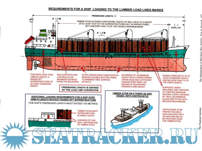

Stable, neutral and unstable conditions are defined in terms of the Centre of Buoyancy 'B the Centre of Gravity G' and the Metacentre ‘M'. The GZ curve is used to illustrate how a vessel s transverse stability changes with increasing angles of heel The effects of a hull s beam, freeboard, draft, fineness of lines and sheer upon the GZ curve are discussed. The six basic criteria of seaworthiness, which must be met by a ship's GZ curve, are defined with an alternative set of criteria for High Fo 'c ’sle vessels.

Passenger vessels. Ship s carrying deck timber cargo. Ships carrying solid bulk cargo, including grain. Ships operating heavy lifts at sea. Windage allowance for ships carrying high deck stows of containers and ships operating in high latitudes where ice build up is a danger.

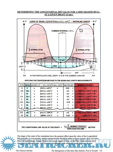

Longitudinal Centre of Buoyancy (LCB) and Longitudinal Metacentre. Longitudinal righting moments. The trim axis and centre of floatation (LCF), location of LCF for a given draft, shift in the LCB due to change of draft, estimating the longitudinal BM value for a vessel, the moment required to change trim by lcm (MCTC). Taking moments of weights about the aft perpendicular (AP) to predict a ship 'sfore and aft drafts. Average and mean drafts defined. The change of trim due a fore and aft shift of weight. The change of trim when moving from salt to fresh water. Trim and stability calculations during drydocking. Beaching and stranding.

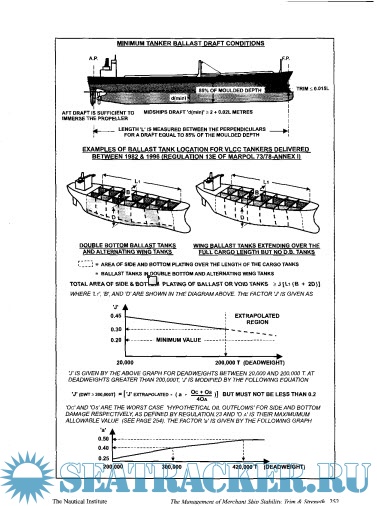

10) The ‘SOLAS’ subdivision and damage stability requirements for passenger ships and cargo vessels and the ‘MARPOL’ tanker subdivision regulations.
These rules are explained and examined with regard to their effects upon a ship s damage stability and trim.

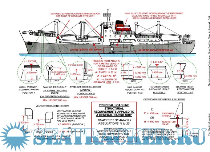

11) The International Load Line regulations for merchant ships.
An outline to the background and aims of the load line regulations. Terms used in the regulations defined. Loadline markings described. Conditions of freeboard assignment explained. Tabulated and corrected freeboard explained. Seasonal and regional load lines explained. Compliance with the regulations explained.
