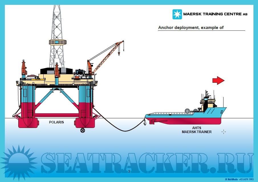

1. Program. Abbreviations Introduction to Anchor Handling Course
2. Risk Assessment. Planning
3. Calculations: Winch, Weight, Catenary
4. Anchor Deployment – PCP. Example of…
5. AH – Winches. Winch Computers. Wire Drums. Chain Wheels
6. Shark Jaws, TRIPLEX (Incl. checklist)
7. Shark Jaws, KARM FORKS
8. Wire Rope: Guidelines. Maintenance
9. Anchor Handling Equipment Swivel – Pin Extractor – Socket Bench
10. Balmoral Marine Marine Equipment Handbook
11. Bruce: Dennla & FFTS Mk 4
12. Vryhof Anchor Manual 2005
13. Anchor Handling Breaking the anchor…..
14. Ship Handling. Manoeuvring Maersk Training Centre A/S
15. Drilling Units / - Operations
