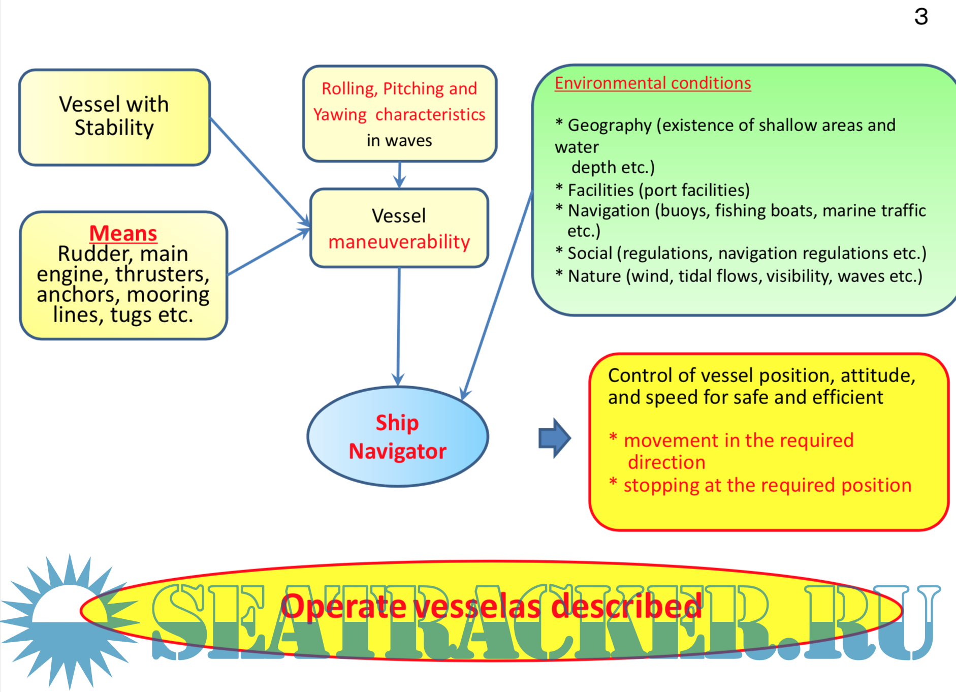

Description: Vessel handling is based on the basic knowledge that a vessel floats in the water and returns to its original position after a list.
It is maneuvered with the assistance of the rudder, main engine(s) and other auxiliary equipment, using knowledge of the rolling, pitching and yawing characteristics of the vessel in waves.
In handling the vessel it is necessary to consider the effects of environmental conditions while controlling the position of the vessel, its attitude, and its speed, to move the vessel in the designed direction in a safe and efficient manner, and to stop at the intended position.
