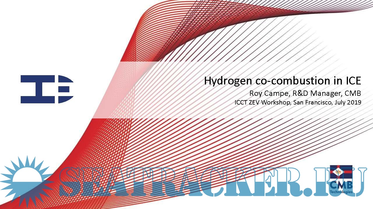

Hydrogen co-combustion in ICE
Year: 2019
Author: CMB
Genre: Presentation
Pages count: 25
