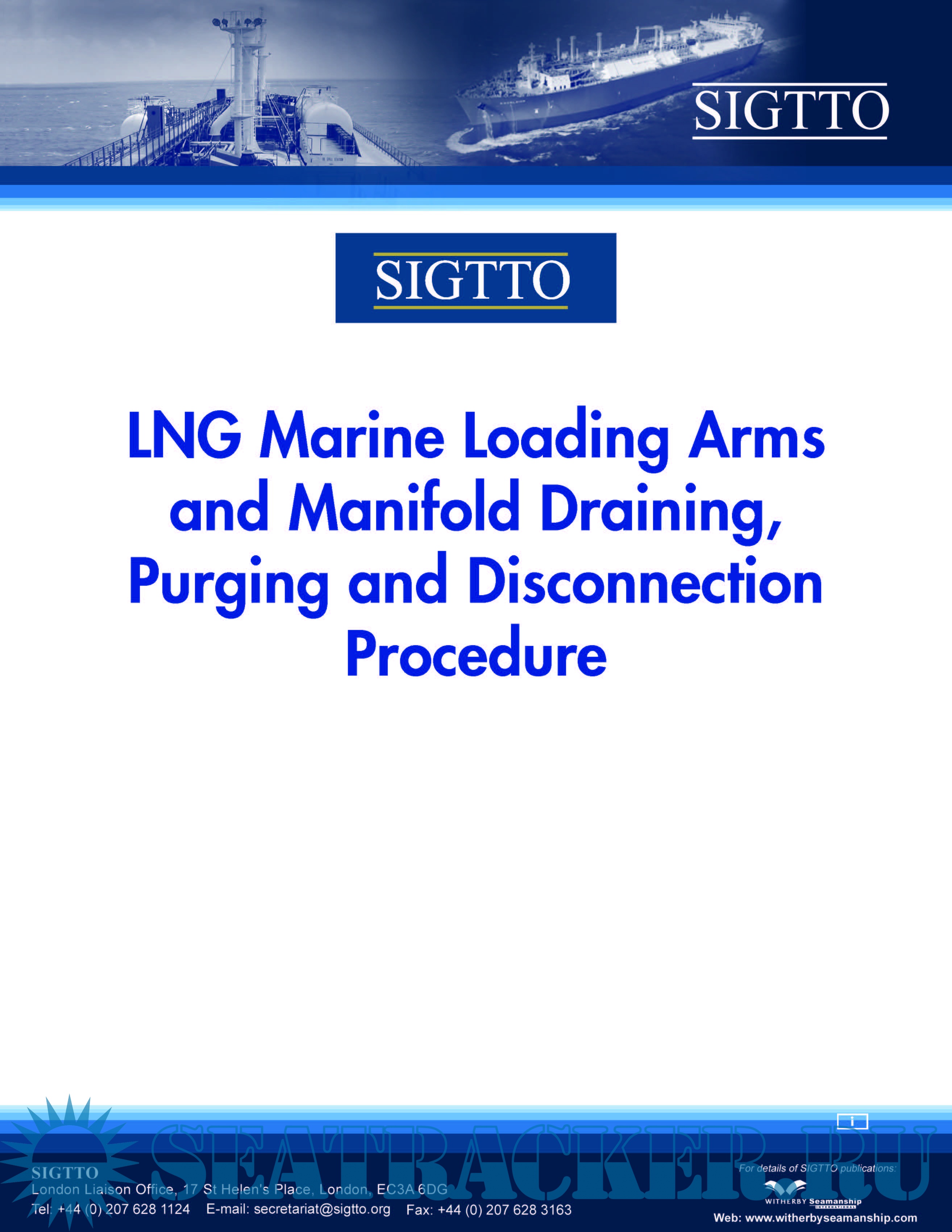

LNG Marine Loading Arms and Manifold Draining, Purging and Disconnection Procedure
Year: 2017
Author: SIGTTO
Genre: Research papers
Publisher: Witherby Publishing Group Ltd
Pages count: 15
Description: This advice has been prepared following reports, from a number of members, that there appears to be confusion and misunderstanding among some ship and jetty operators over the safe conduct of this operation.
This advice specifically pertains to terminals employing rigid marine loading arms (MLAs). (The basic principles are applicable for hose systems that may be used for LNG ship-to-ship transfer, but there will be differences in the details.)
