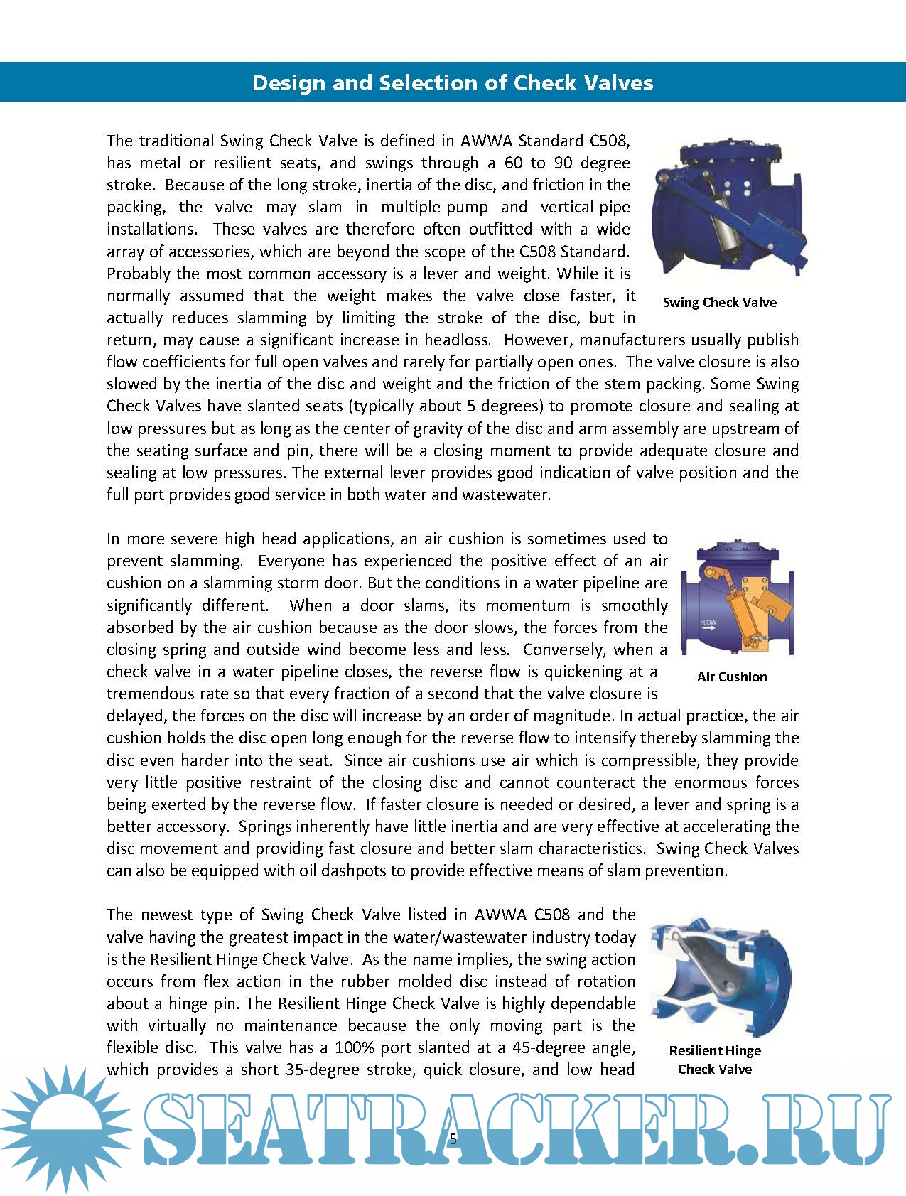

surges caused by sudden closure. Every pump station designer has witnessed check valve slam,
which is caused by the sudden stoppage of reverse flow through a closing check valve. To
prevent slam, an automatic check valve must either close very quickly or close slowly by using
oil dashpot devices.
