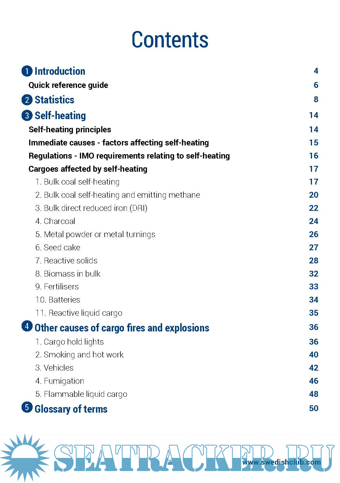

‘Fire!’ offers loss prevention advice on a number of incidents – focusing specifically on self - heating cargoes,
but also examining those vessel fires caused by other sources such as cargo hold lights, fumigation, movement
of cargo and of course smoking and hot work. It also highlights how different vessel types fare when the
frequency of cargo fires is compared. Tanker figures are found to be relatively low, a testament to the tight
regulation and safety culture that exists in this industry. On the other hand RoRo figures are surprisingly high
due to the non-homogeneous nature of the cargo they carry.

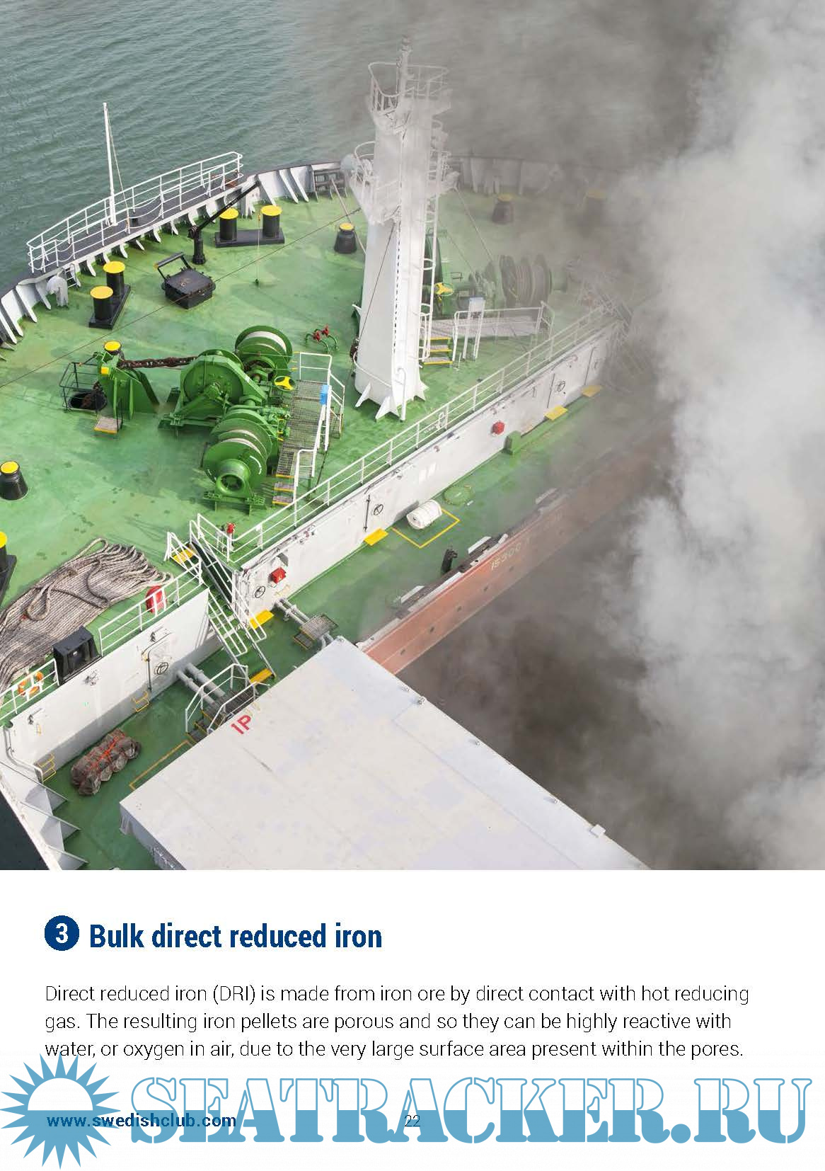

Neil Sanders, explains: “Self
-heating and related issues can affect a wide variety of cargoes including coal, iron in the form of
direct reduced iron (DRI), metal turnings, charcoal, seed cake, biomass, fertilisers, solid chemicals
and liquid chemicals. Whilst the full relevant International Maritime Solid Bulk Cargoes Code
(IMSBC) or International Maritime Dangerous Goods Code (IMDG) requirements must always be understood and followed, ‘
Fire!’ is aimed at supporting that understanding and providing valuable support to the seafarer.”
