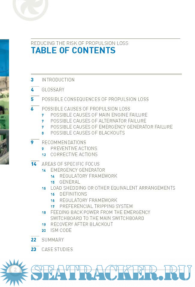

REDUCING THE RISK OF PROPULSION LOSS, Operational guidance for preventing blackouts and main engine failures
Year: 2017
Author: The London P&I Club
Pages count: 24
Description: The purpose of this booklet is
to provide general guidance
and practical advice to marine
engineers and ship owners on
blackout and main engine failures,
the risks associated with propulsion
loss and the precautions to
manage these risks.
