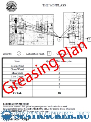

Greasing Plan
Number of pages: 17
Description:
Ship’s particulars
The Hatch Covers
The Records of the Lubrication maintenance of the Hatch Covers
The Tween Deck Hatch Covers
The Records of the Lubrication maintenance of the Tween Deck Hatch Covers
The Tween Deck Hatch Cover Winch
The Records of the Lubrication maintenance of the Tween Deck Hatch Covers Winch
The Boat Davit
The Records of the Lubrication maintenance of the Boat Davit
The Crane with Air Motor
The Records of the Lubrication maintenance of the Crane with Air Motor
The Capstan
The Records of the Lubrication maintenance of the Capstan
The Windlass
The Records of the Lubrication maintenance of the Windlass
