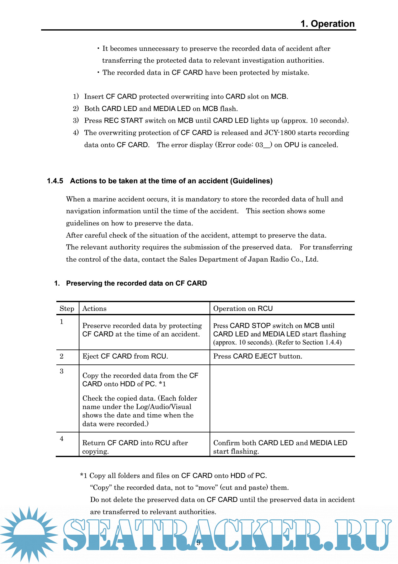

If an accident has occurred, it is mandatory to preserve the record data immediately.
In case an accident has occurred, please preserve the record data according to the procedure
described in 1.4.4: “Actions to be taken at the time of an accident”
To ensure the proper operation, we recommend you to read the procedure carefully.
