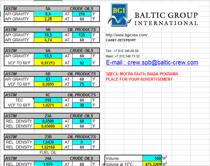

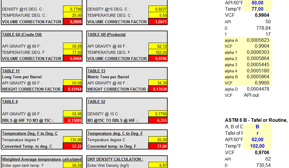

Description: Расчётные ASTM таблицы по нефти и нефтепродуктам 5A, 6A, 5B, 6B, 6C, 23A, 24A, 23B, 24B, 24C, 53A, 54A, 53B, 54B, 54C.
ASTM / API TABLES
- TABLE 54A (Crude Oil).
- TABLE 54B (Products).
- TABLE 6A (Crude Oil).
- TABLE 6B (Products).
- Temperature Deg. F to Deg. C.
- Temperature deg. C to Deg. F.
- Weighted Average temperature calculated.
- DRY DENSITY CALCULATION.
- PARTIAL WET DENSITY CALCULATION.
- ASTM 6 A - Tafel or Routine.
- ASTM 6 B - Tafel or Routine.

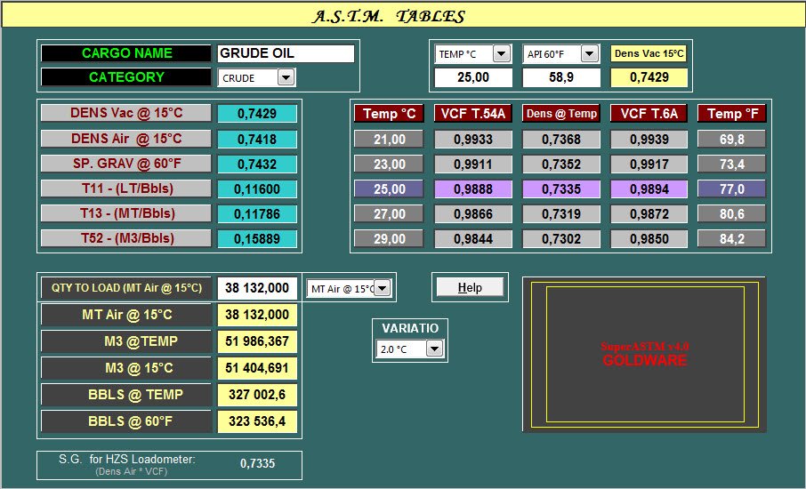

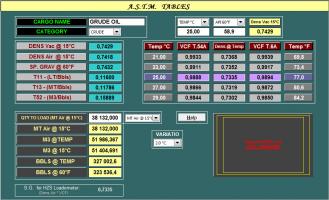

Super ASTM ver. 4.0
- DENS Vac @ 15°C
- DENS Air @ 15°C
- SP. GRAV @ 60°F
- T11 - (LT/Bbls)
- T13 - (MT/Bbls)
- T52 - (M3/Bbls)
- QTY TO LOAD (MT Air @ 15°C)
- MT Air @ 15°C
- M3 @TEMP
- M3 @ 15°C
- BBLS @ TEMP
- BBLS @ 60°F
