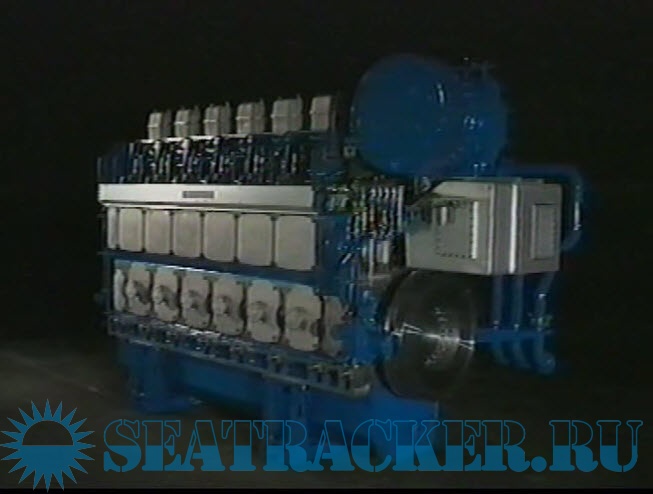

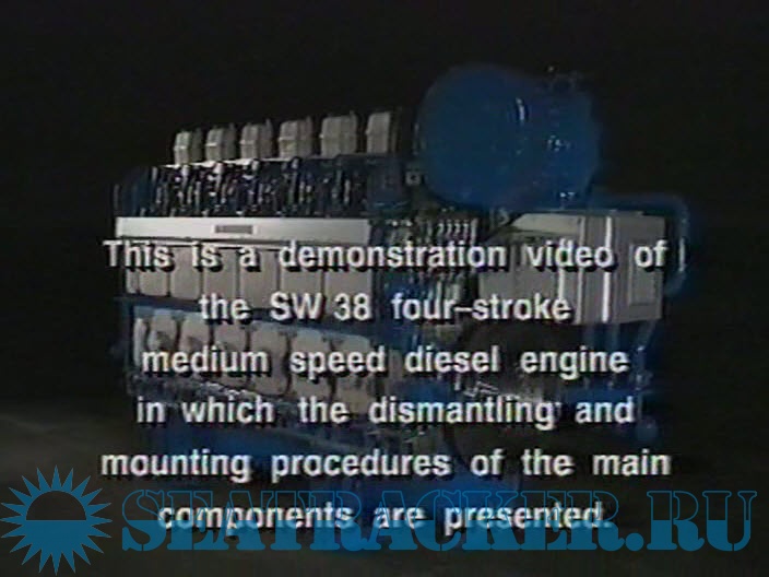

Description: Lightest and most compact heavy duty engine, also used for generating set applications

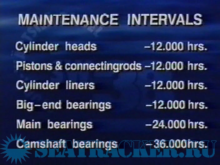

The Wärtsilä 38 was developed in response to a need in the market for an engine in the 400 mm cylinder bore class. The high level of technology incorporated in this engine, together with its design, and the power plant built around it, are all focused on achieving the lowest possible kWh production cost.
The Wärtsilä 38 has fewer parts, less maintenance requirements, low fuel consumption, reduced emission levels, and has the ability to run reliably on a variety of fuels.
The Wärtsilä 38 engine is fully compliant with the IMO Tier II exhaust emissions regulations set out in Annex VI of the MARPOL 73/78 convention.

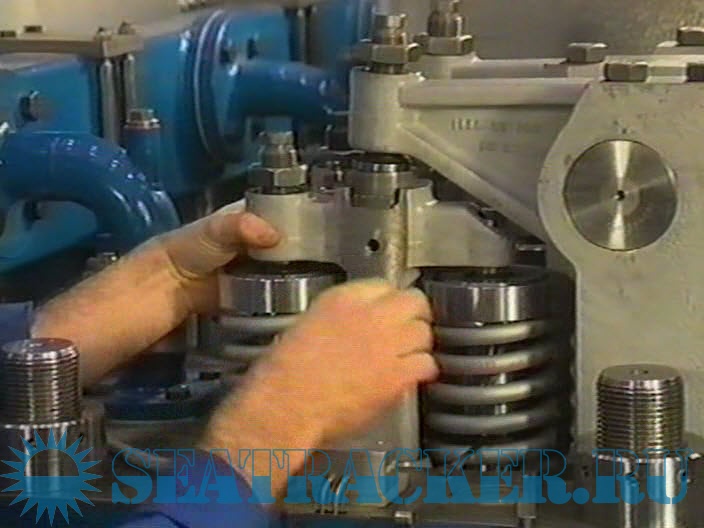

01-Removal of Cylinder Head
02-Removal of Piston and Connecting Rod
03-Disassembly of Crank pin Bearing
04-Removal of Cylinder Liner
05-Disassembly of The Main Bearing
06-Assembly of The Main Bearing
07-Assembly of Cylinder Liner
08-Assembly of The Crank Pin Bearing
09-Assembly of Piston and Connecting Rod
10-Assembly of Cylinder Head
11-Removal of A Camshaft Section
12-Replacement of A Camshaft Section
