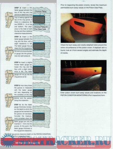

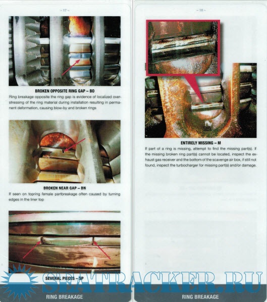

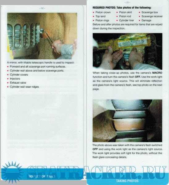

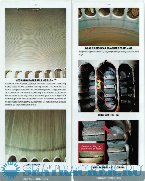

Description: PART I of this booklet was developed to provide a photographic representation of each piston and liner condition listed on the MAN Diesel & Turbo Inspection through Scavenge Port form.
GENERAL CATEGORIES on the MAN form match the name on the tab at the bottom of each booklet page (black arrow).
SPECIFIC CONDITIONS on the form are represented by photographs (red arrow) in this booklet.
PARTll I In ace ordance MAND form, C taring R spectio this bo a pict tion of proced ing to P Groove depth, clearan crown b with iesel & Turbo ondition Manieport (Port inn), PART Ill of oklet provides orial descripmeasurement ures pertainressure Relief (CL groove) ring groove ce and piston urn-away.
PARTI Supplement to the MAN Diesel & Turbo form titled Inspection Through Scavenge Port
PART II SCAVENGE PORT INSPECTION TOOLS & TAKING PHOTOS
PART Ill Supplement to the MAN Diesel & Turbo form titled PISTON CONDITION MONITORING (Port Inspection)
APPENDIX Inspection Through Scavenge Port Condition Monitoring Report (Port Inspection)
