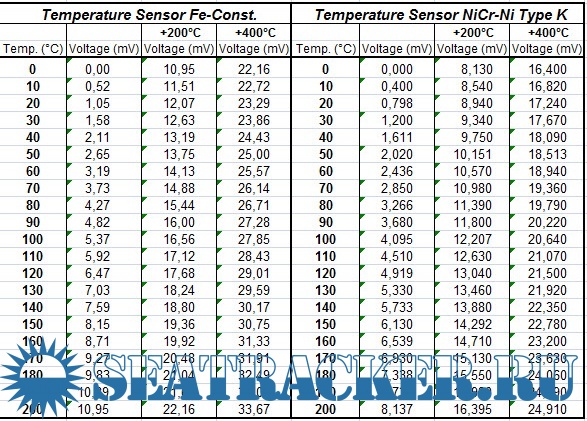

Conversion Tables for Sensors&Transdusers
Формат:
Description: Temp. (°C) - Resistance (Ohm)
Temp. (°C) - Voltage (mV)
Current 4...20mA - Press. (bar)
Pressure 0...6bar - 4...20mA
Pressure 0...10bar - 4...20mA
Pressure 0...40bar - 4...20mA
4...20mA - Resistance(Ohm)
Conversion Tables BEST.xls
Download [493 B]
