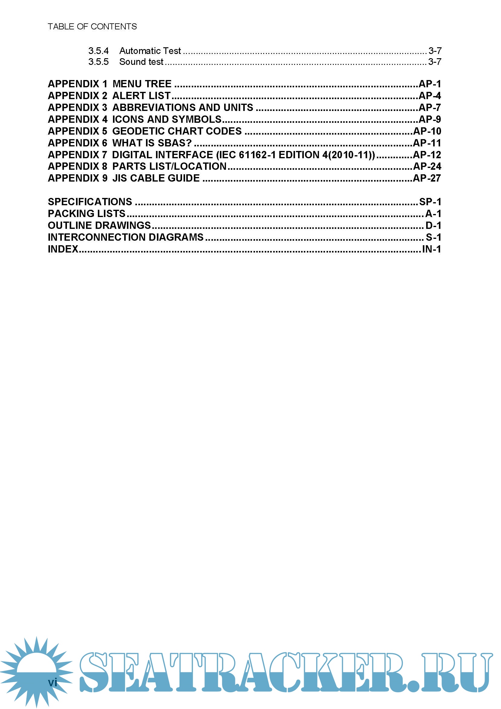

Furuno Operator's Manual Satellite Compass Model SC-70, SC-130
Year: 2020
Author: Furuno
Pages count: 141
Description: The SC-70/SC-130 is a new Satellite Compass™ designed with FURUNO advanced GPS kinematic technology. This compass has a wide range of applications for both land and sea vessels.
