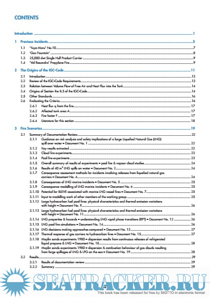

Introduction ...........................................................................................................................................................1
1 Previous Incidents .............................................................................................................................................5
1.1 ‘Yuyo Maru’ No.10.....................................................................................................................................................7
1.2 ‘Gaz Fountain’ ...........................................................................................................................................................8
1.3 25,000 dwt Single Hull Product Carrier ........................................................................................................................9
1.4 ‘Val Rosandra’ Propylene Fire......................................................................................................................................9
2 The origins of the IGC-Code............................................................................................................................11
2.1 Introduction ..............................................................................................................................................................13
2.2 Review of the IGC-Code Requirements........................................................................................................................13
2.3 Relation between Volume Flow of Free Air and Heat Flux into the Tank..........................................................................14
2.4 Origins of Section the 8.5 of the IGC-Code.................................................................................................................14
2.5 Other Standards .......................................................................................................................................................16
2.6 Evaluating the Criteria...............................................................................................................................................16
2.6.1 Heat flux q from the fire............................................................................................................................... 17
2.6.2 Affected tank area A................................................................................................................................... 17
2.6.3 Fire factor F................................................................................................................................................ 17
2.6.4 Literature for this section .............................................................................................................................. 18
3 Fire Scenarios.................................................................................................................................................19
3.1 Summary of Documentation Review............................................................................................................................22
3.1.1 Guidance on risk analysis and safety implications of a large Liquefied Natural Gas (LNG)
spill over water – Document No. 1 ............................................................................................................... 22
3.1.2 Key results extracted ................................................................................................................................... 22
3.1.3 Cloud fire experiments................................................................................................................................. 23
3.1.4 Pool fire experiments................................................................................................................................... 23
3.1.5 Overall summary of results of experiments – pool fire & vapour cloud studies .................................................. 24
3.1.6 Results of 40 m3 LNG spills on water – Document No. 2................................................................................. 24
3.1.7 Consequence assessment methods for incidents involving releases from liquefied natural gas
carriers – Document No. 4........................................................................................................................... 24
3.1.8 Consequences of LNG marine incidents – Document No. 5 ............................................................................ 25
3.1.9 Consequence modelling of LNG marine incidents – Document No. 6 .............................................................. 25
3.1.10 Potential for BLEVE associated with marine LNG vessel fires – Document No. 7................................................ 25
3.1.11 Input to modelling work of other members of the working group..................................................................... 25
3.1.12 Large hydrocarbon fuel pool fires: physical characteristics and thermal emission variations
with height – Document No. 9...................................................................................................................... 26
3.1.13 Large hydrocarbon fuel pool fires: physical characteristics and thermal emission variations
with height – Document No. 11.................................................................................................................... 26
3.1.14 LNG properties & hazards – understanding LNG rapid phase transitions (RPT) – Document No. 12 .................. 26
3.1.15 LNG pool fire simulations – Document No. 14............................................................................................... 26
3.1.16 LNG decisions making approaches compared – Document No. 13................................................................. 27
3.1.17 Thermal response of gas carriers to hydrocarbon fires – Document No. 15...................................................... 27
3.1.18 Maplin sands experiments 1980 – dispersion results from continuous releases of refrigerated
liquid propane & LNG – Document No. 18................................................................................................... 28
3.1.19 Maplin sands experiments 1980 – dispersion & combustion behaviour of gas clouds resulting
from large spillages of LNG & LPG on the sea – Document No. 19 ................................................................. 28
3.2 Results......................................................................................................................................................................29
3.2.1 Results of documentation review................................................................................................................... 29
3.2.2 Summary ................................................................................................................................................... 29
This book has been released for free by SIGTTO in electronic formatviii

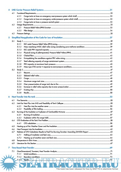

4 LNG Carrier Pressure relief Systems ................................................................................................................31
4.1 Functional Requirements............................................................................................................................................33
4.1.1 Cargo tanks to have an emergency over-pressure system which shall .............................................................. 33
4.1.2 Cargo tanks to have an emergency under-pressure system which shall............................................................ 33
4.1.3 Cargo tanks to have a pressure control system .............................................................................................. 33
4.2 Design Requirements.................................................................................................................................................33
4.2.1 Pressure Relief Valve (PRV) function .............................................................................................................. 33
4.2.2 Pilot design................................................................................................................................................. 34
4.2 Pressure Settings .......................................................................................................................................................35
5 Simplified reapplication of the Code for Loss of Insulation................................................................................37
5.1 Study 1 ....................................................................................................................................................................39
5.1.1 IGC code Pressure Relief Valve (PRV) sizing................................................................................................... 39
5.1.2 Moss rosenberg LNGC relief valve sizing considering pure methane conditions ............................................... 39
5.1.3 IGC code PRV required capacity .................................................................................................................. 41
5.1.4 Physical sizing of pilot-operated, Pressure Relief Valves (PRV) ......................................................................... 41
5.1.5 Choked flow ............................................................................................................................................... 42
5.1.6 Extrapolating fire conditions against PRV valve sizing .................................................................................... 42
5.1.7 Total relieving capacity of cargo containment system...................................................................................... 43
5.1.8 PRV capacity at maximum back pressure ...................................................................................................... 45
5.1.9 Moss type LNG carrier – response to over-pressure conditions........................................................................ 46
5.2 Study 2 ....................................................................................................................................................................47
5.2.1 Résumé ...................................................................................................................................................... 47
5.2.2 Selected relief valve..................................................................................................................................... 47
5.2.3 Cargo ........................................................................................................................................................ 48
5.2.4 Maximum cargo tank size............................................................................................................................ 48
5.2.5 Over pressurization of cargo tank due to fire ................................................................................................ 49
5.2.6 Increase in relief valve capacity due to over pressurization............................................................................. 49
5.2.7 Existing ship ............................................................................................................................................... 50
5.2.8 Results........................................................................................................................................................ 50
6 Heat Transfer Into the tank ..............................................................................................................................53
6.1 Fire Scenario............................................................................................................................................................55
6.2 Limit for Heat Flux into LNG and Possibility of Tank Collapse ........................................................................................55
6.2.1 Heat flux into the weather cover ................................................................................................................... 55
6.2.2 Possibility of film boiling .............................................................................................................................. 56
6.3 Burning of the Insulation or Explosion of Combustible Mixtures ....................................................................................57
6.3.1 Burning of insulation ................................................................................................................................... 57
6.3.2 Explosion within the cargo hold.................................................................................................................... 57
6.4 CFD Evaluation of the Tank Fire Problem.....................................................................................................................58
6.4.1 CFD calculation .......................................................................................................................................... 58
6.5 Heating up of the Weather Cover and the Insulation ....................................................................................................60
6.6 Heat Transport into the Insulation ...............................................................................................................................62
6.7 Relation of CFD Calculation Results to Pool Fire Burning Duration According SANDIA Report .........................................63
6.7.1 Melting of insulation and leak size................................................................................................................ 63
6.7.2 Heating up of weather cover and leak size.................................................................................................... 64
6.8 Temperature in Skirt Area..........................................................................................................................................65
6.9 Literature for this Section ...........................................................................................................................................67

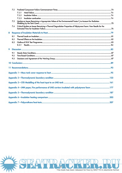

7.2 Predicted Component Failure Commencement Times....................................................................................................74
7.2.1 Metal failure............................................................................................................................................... 74
7.2.2 Insulation failure ......................................................................................................................................... 74
7.2.3 Insulation combustion .................................................................................................................................. 74
7.3 Update on Issues Remaining – Appropriate Values of the Environmental Factor FI to Account for Radiation
Shielding by the Tank Cover.......................................................................................................................................75
7.4 Critical Update on Issues Remaining – Thermal Degradation Properties of Polystyrene Foam: New Results for the
Estimated Time for Insulation Failure...........................................................................................................................76
8 response of Insulation Materials to Heat..........................................................................................................79
8.1 Thermal Loads on Insulation.......................................................................................................................................81
8.2 Thermal Effects on the Insulation.................................................................................................................................82
8.3 Outline of DNV Test Programme.................................................................................................................................83
8.3.1 Results........................................................................................................................................................ 84
9 Discussion ......................................................................................................................................................85
9.1 Steady State Conditions.............................................................................................................................................87
9.2 Time Based Conditions ..............................................................................................................................................87
9.3 Decisions and Agreement of the Working Group.........................................................................................................87
10 Conclusions ....................................................................................................................................................89
11 recommendations...........................................................................................................................................93
appendix 1 – Moss tank cover response to heat ....................................................................................................95
appendix 2 – Thermodynamic boundary condition..............................................................................................133
appendix 3 – CFD Modelling of the heat input to an LNG tank .............................................................................161
appendix 4 – JHM paper, Fire performance of LNG carriers insulated with polystyrene foam ................................177
appendix 5 – Thermodynamic boundary condition..............................................................................................187
appendix 6 – Insulation heating comparison .......................................................................................................203
appendix 7 – Polyurethane heat tests..................................................................................................................207
