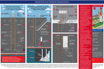

Interactive Pilot Transfer Arrangements Poster
Year: 2025
Author: Kevin Vallance, John Slater
Genre: Poster
Publisher: UK Maritime Pilots’ Association (UKMPA)
Edition: 1st
Format: HTML
Pages count: 1

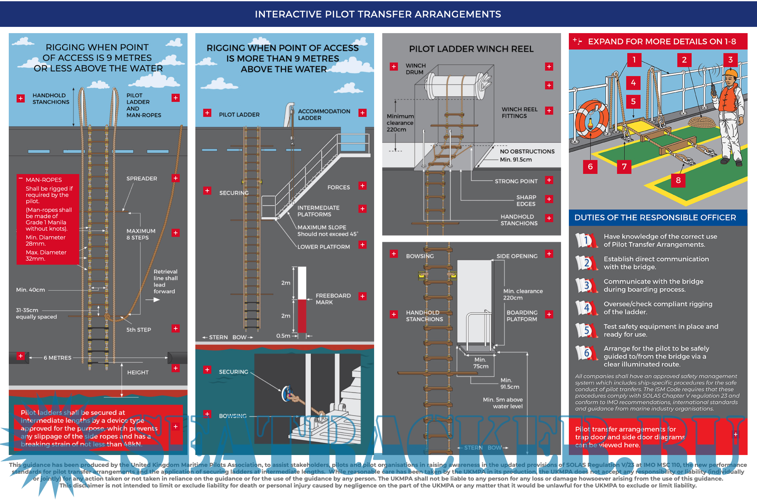

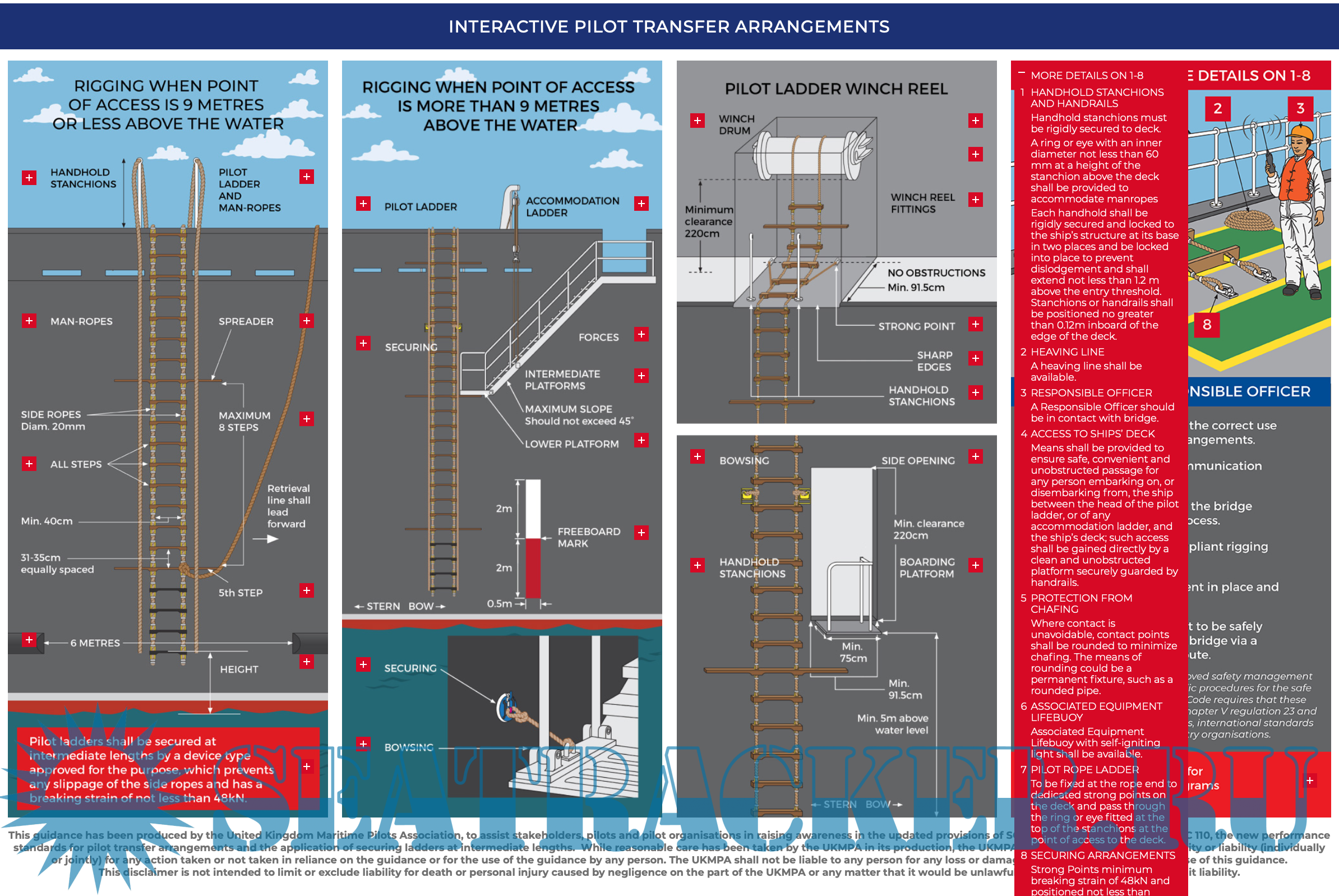

Description: To support industry’s transition, the UK Maritime Pilots’ Association (UKMPA) has developed an interactive poster illustrating compliant arrangements under the new regulation. This practical tool is intended to Help Crew Familiarise themselves with requirements and prepare ahead of the implementation dates.
This poster, developed by Kevin Vallance, John Slater and Jon Smith of the UKMPA T&TC, in collaboration with James Musgrove, is designed to support the transition to the updated SOLAS V/23 regulations. These changes, agreed upon during the IMO MSC 110 meeting on June 25, outline new requirements for pilot transfer arrangements.
The updated regulations will apply to:
– New installations from January 1, 2028.
– Existing installations on SOLAS ships during their first survey after January 1, 2029.
– Non-SOLAS ships starting January 1, 2030.
