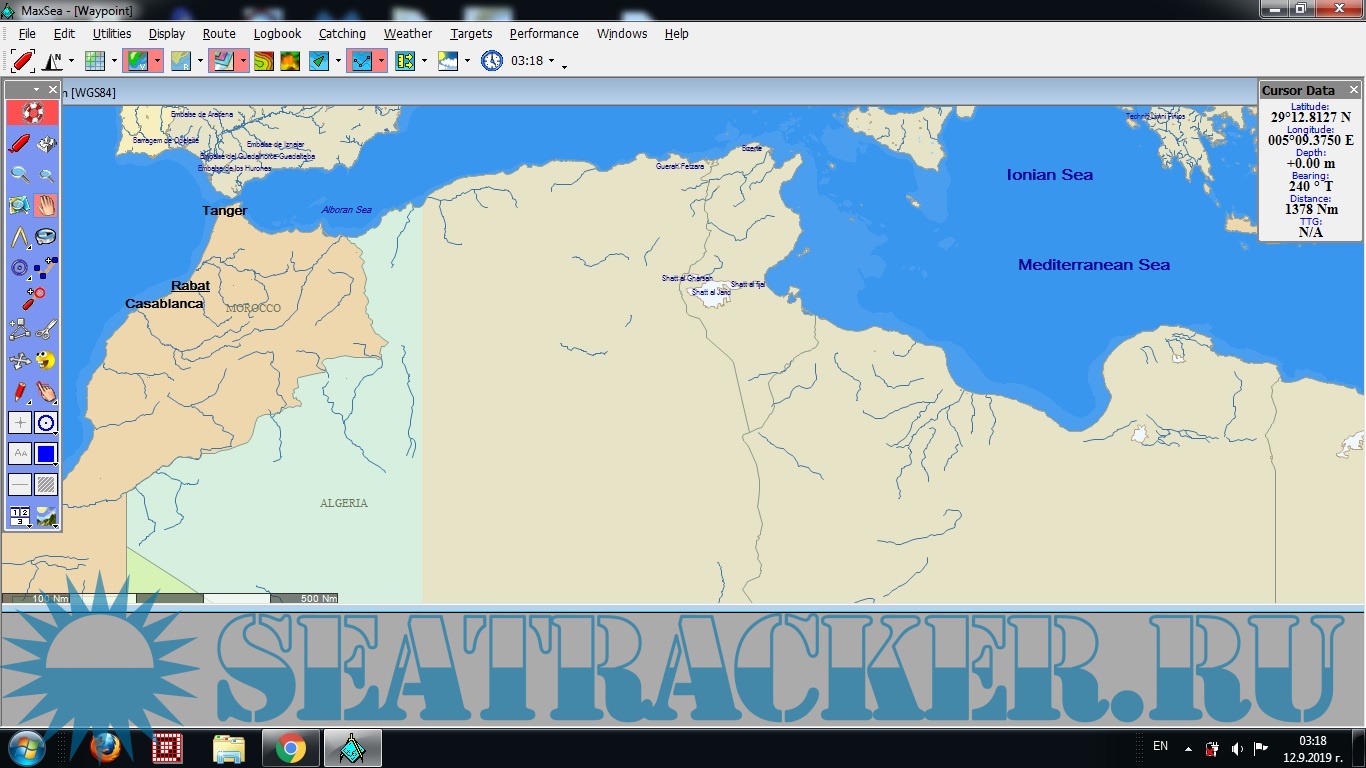

kuk0_0   12-Sep-2019 01:20
Hello,
How can I change the port COM? Now it is 6 and it shows me that there is not nav data. I want to receive an information from COM 12.
How to adjust the display wide? Its on half of my screen.
